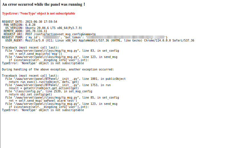

An error occurred while the panel was runningļ¼
telegram.error.BadRequest: Chat not found...
Please fix help me. Thanks

When I try to add Telegram I get this error
