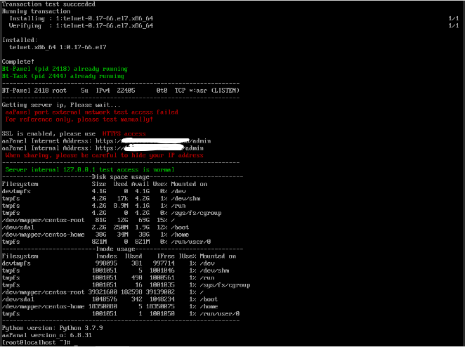

Hello, try using this script to check if it is normal?
curl -k https://www.aapanel.com/script/aapanel_check.sh | bash
- Edited
Tried with "https" to access the panel and it's work. Thanks for helping me )
