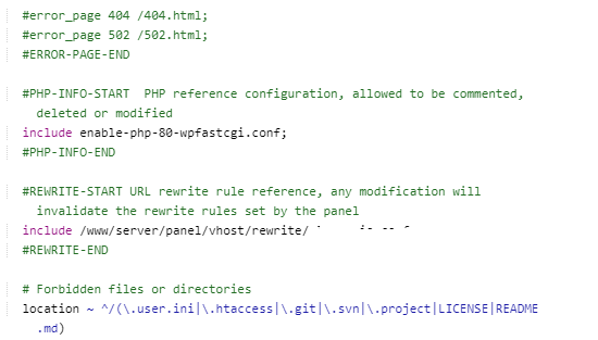

Hello, I have done the steps here:
- Added these 4 lines in nginx configuration
fastcgi_cache_key "$scheme$request_method$host$request_uri"; fastcgi_cache_path /dev/shm/nginx-cache/wp levels=1:2 keys_zone=WORDPRESS:100m inactive=60m max_size=1g; fastcgi_cache_use_stale error timeout invalid_header http_500; fastcgi_ignore_headers Cache-Control Expires Set-Cookie;

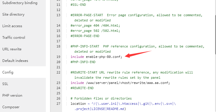

- Changed the site configuation from
include enable-php-81.conf;
toinclude enable-php-81-wpfastcgi.conf;
- Installed Nginx Helper plugin in Wordpress
- Added
define('RT_WP_NGINX_HELPER_CACHE_PATH','/dev/shm/nginx-cache/wp');
to wp-config.php
And everything seems to work, I get cache HIT in the header response for the wordpress site main page. Except when I try to go to any other page, I get 404. I notice that the url that doesn't work follows index.php
routing page forexample: https://domain.com/index.php/contact/
to go to contact page. What am I missing here? Any ideas?
Regards,
Tony

I added a new site using the wordpress deploy option. Then copy the old contents over to the new site. Unfortunately, I still have the same issue, meaning it is not the configuration? May be there is some settings/plugins that affect this fastCGI setting?

aaPanel_Kern It is not a new site, that is why I want to add it after the fact. Everything seems to be working for the main page, I get Cache HIT but for other pages I get 404.
aaP_hareeshnarayan1982 That is what I'm trying to figure out, which WP config/file needs to be changed without reinstalling the site. If nothing works I'll have to try what you suggested.

aaPanel_Kern When we use wp migration nothing has to be done, i had migrated 4 wp sites from ols to NGINX + Fastcgi without any rewrite.
I thought it was something to do with rewrite also, but when I changed back to using enable-php-81.conf
instead of enable-php-81-wpfastcgi.conf
everything works fine (minus the caching), no 404 error. And since rewrite is configured on nginx level, I don't think there are any rewrites in those php conf files.
I will try to create a new site and test whether fastcgi works on that first, then migrate the old site to see if that helps.
aaP_tony
enable-php-81-wpfastcgi.conf This is the configuration file dedicated to deploy wordpress. You are advised to check whether there is an Nginx Helper
