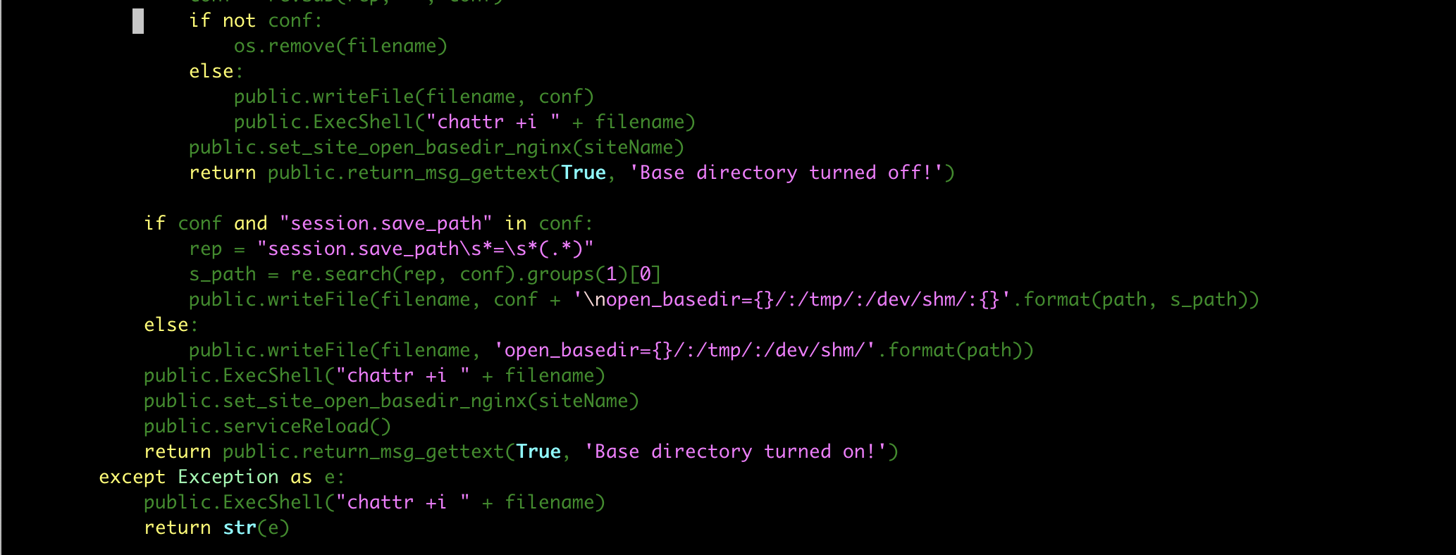

Hello, try to add the relevant directory to the .uer.ini file
aaPanel_Kern Thank you! it works well now.
I want to share my work here.
I did update the file: /www/server# vim panel/class/panelSite.py
As you can see in the picture, I added /dev/shm, /dev/shm is my cache path.
Do not forget to restart the panel to apply your change.
