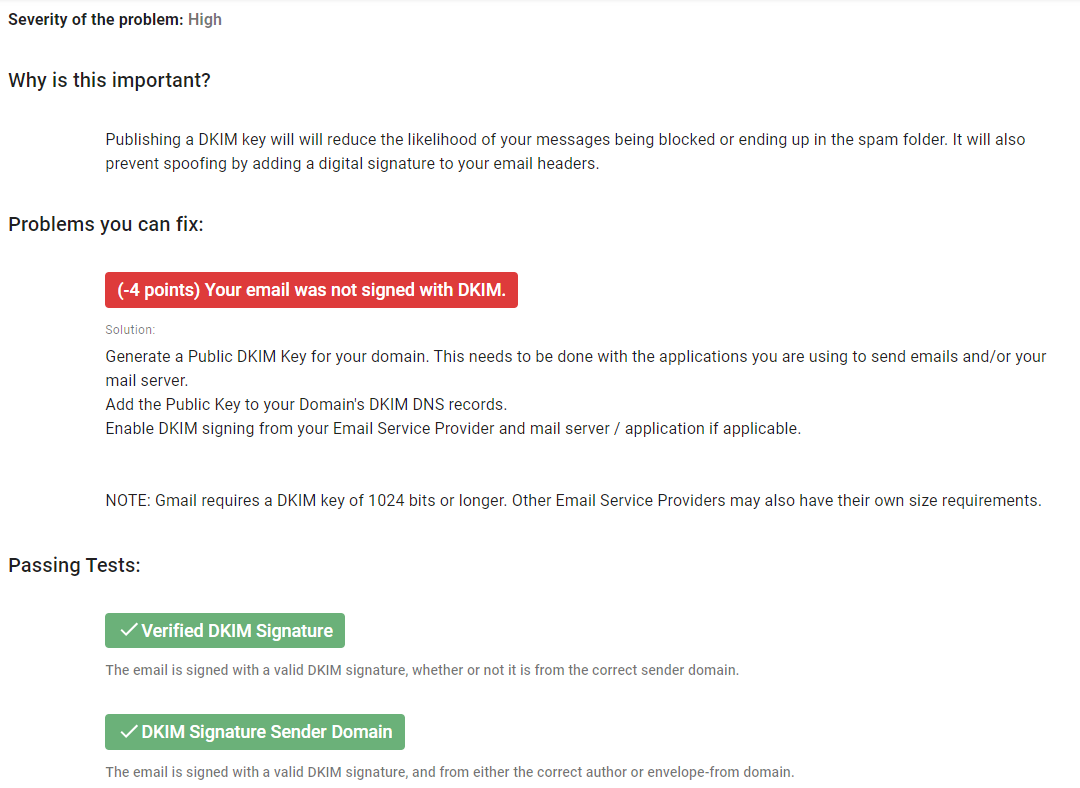

Although all seems to be working for the mail server app on aapanel, when I send a mail to a test service like mailgenius, it says that the mail is not DKIM signed

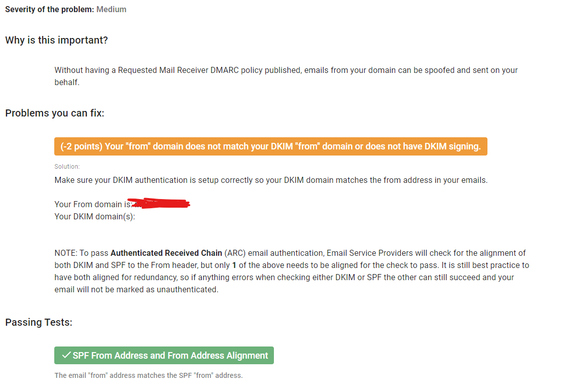

Also this might be related
Since I have two domains in the mail server app, the "from" header of the emails is always the same (VPS hostname) although the email is being sent from one of those domains

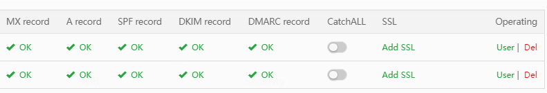

As a side problem, whenever I add a valid SSL as mentioned in the official guide (making a SSL with a pan domain activated via DNS verification and then applying the same for the mail server app) for each domain on my mail server, I get the "add SSL" button as if I didn't added a valid SSL record, instead the expiry date as in others screenshots. How can I get over this?

    Hello, please try to reapply for SSLs at the mail server. At the same time, check the postfix configuration, which can be viewed in the server status

      About the SSL part I didn't try it since I changed the OS of my VPS from ubuntu to CentOs, seems that there is a bug in ubuntu that doesn't let the SSL to be saved on the domains listed on the mail server app. But if someone else's has that problem and can't change its OS maybe your solution might be of help.
        Josdansd
        The ubuntu22 has not been adapted yet. can use the ubuntu20 and use ssl normally
