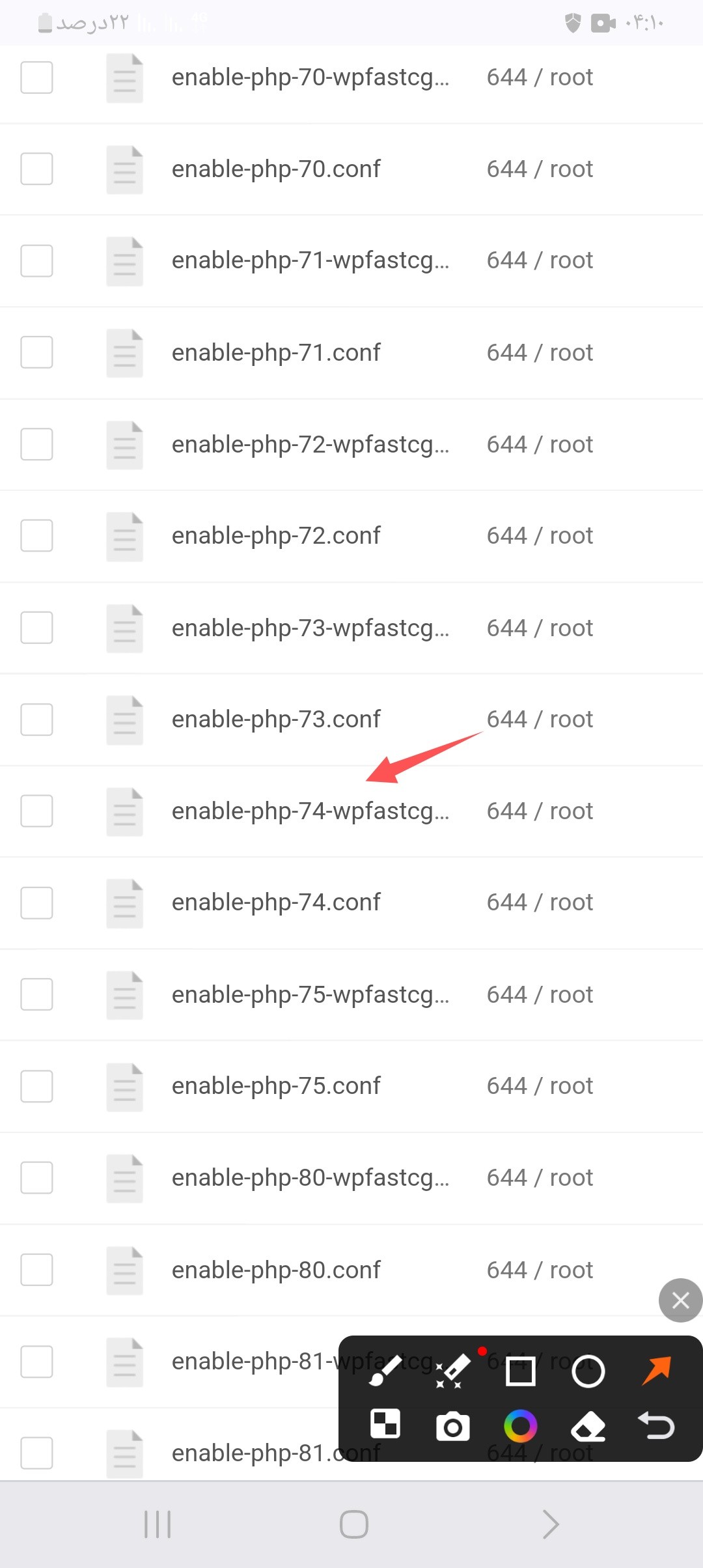

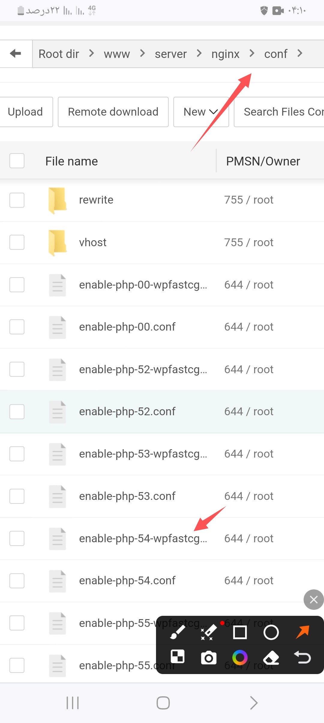

aaPanel_Kern Hello, whatever I do, it doesn't get disabled. I also removed the HSTS code. Do you suggest that the problem might be due to nginx 1.22?
I have Debian 11
aaPanel forces HSTS on domains
Please tell me if it's not adjustable so I can stop doing the various settings because I'm confused

Hello, you need to test this yourself. Do you use incognito mode to access? Do you want to restart nginx after modifying the configuration?
- Edited
aaPanel_Kern 1- no 2- yes

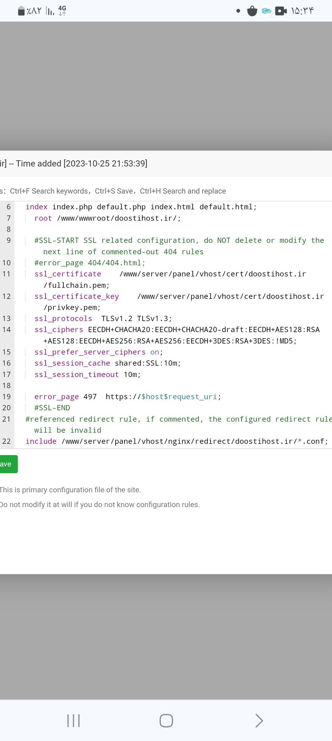

See, I removed it from this section, but it does not apply
add_header Strict-Transport-Security "max-age=63072000;";
