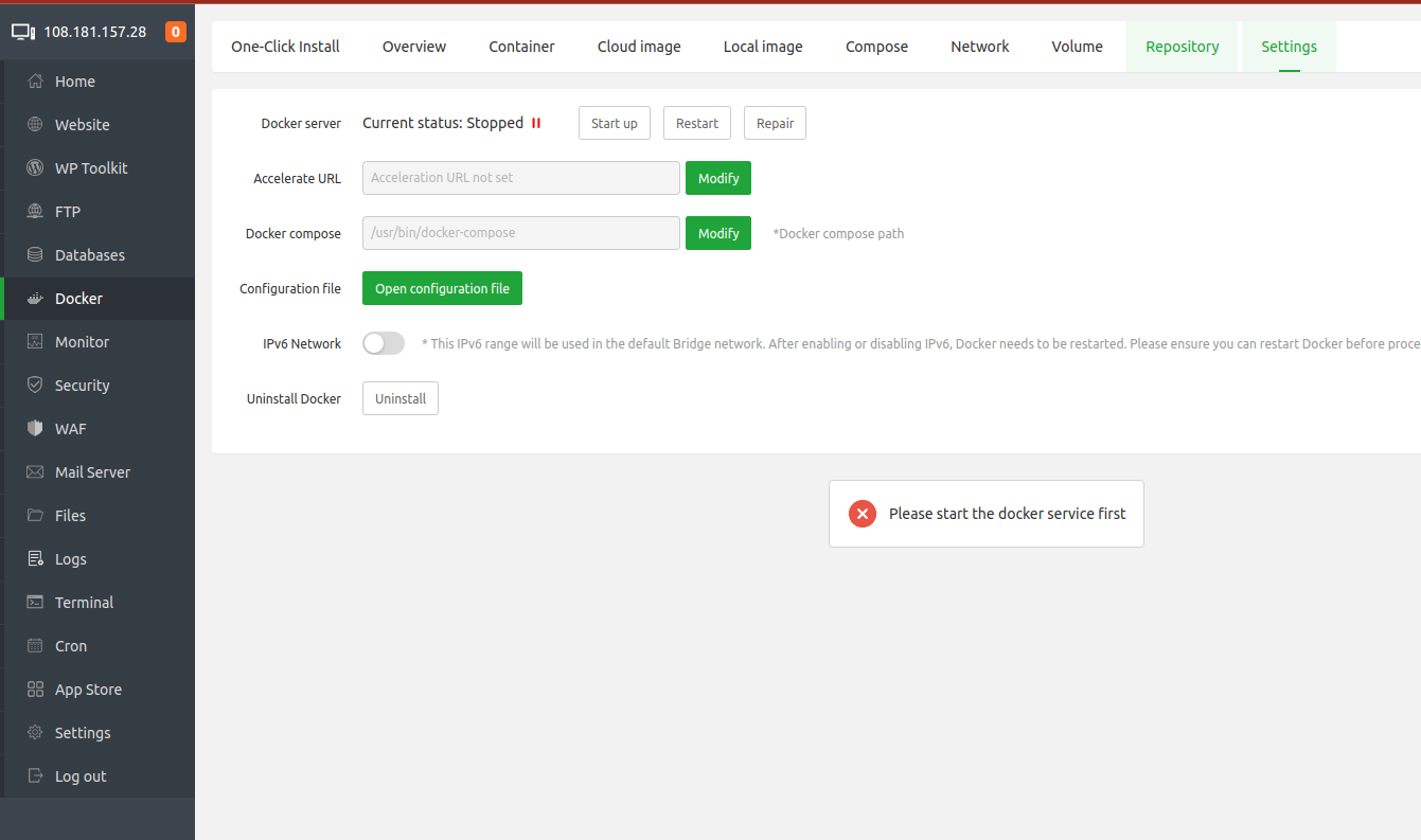

After updated to 7.0.11 docker panel not working suddenly, and it seem the panel unable retrieve my system's docker status, I have tried to start and restart by clicking the button on the panel. Unfortunately, it still not working.

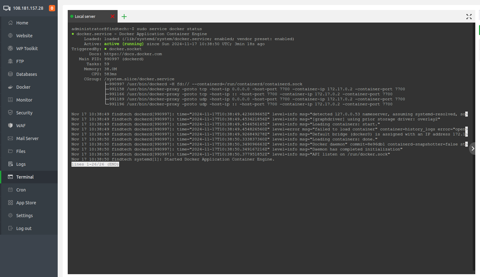

Hello, try reinstalling the docker of the python library
btpip install docker -I
May I know how to do it, it shown Unsupported command
to me, when I'm copy and paste the given command. Tq.
FYI, My server running Ubuntu 22.04.3 LTS
Is it possible to copy and paste in the terminal or use the ssh tool?
Hi, I managed to do it in sudo
