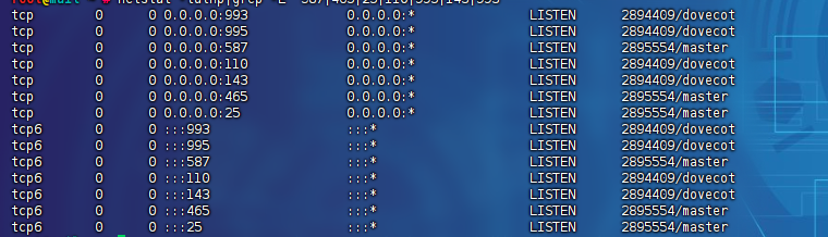

      Hello, check if the port is in use? Are the corresponding ports open in the system firewall and server provider's security group?
      netstat -tulnp|grep -E "587|465|25|110|995|143|993"
      aaP_greatvpn
        This seems normal. Have you tried restarting postfix? Is there a server security group? Are the relevant ports allowed?
