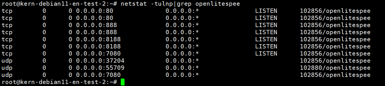

Why, aaPanel again get old bugs? Debian 11 install: Not working firewall (50% chance), OLS port 443 not listening (80% of server installs). Everything worked before, now the old errors are back. When repair it???

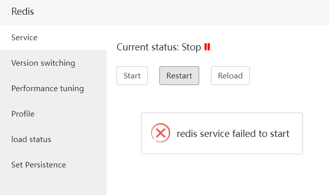

The Redis can´t start too:
In appstore there si UPDATE to 7.0.11 older version, but doesnt help... A make same things on all server, but 3 things not work normal (OLS SSL port, Firewall randomly install, today Redis can´t load).

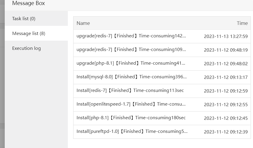

This is the 17th VPS. I do same things, same OS Debian 11, updated. Installing: Fail2ban, PHP 8.1, OLS, MySQL 8.0, Redis. That is all.
Okay, randomly not work: OLS 443 port (not listening), Firewall not installed (okay, I install again with CMD), yet new Redis version in aaPanel and not work...
On one server the OLS SSL, on second Firewall, third OLS SSL and Redis... 13 servers are fine, after it random errors (on same Debian).

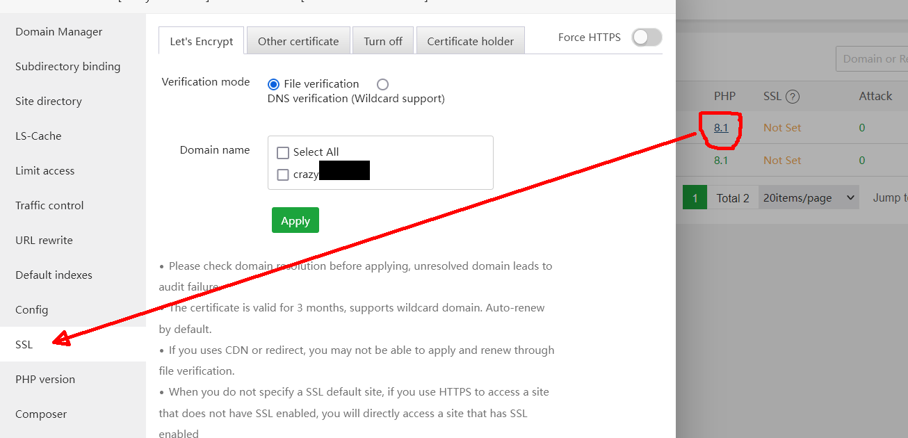

- OLS Have you added the website and configured SSL? If not, it will not listen to port 443.
SSL:

- New Redis, but can´t run it... Pause icon nonstop
- Yes, website with SSL certificates, still Not Listening on random fresh installs. How resolve it?
(on other VPS when no SSL site, there is still listening 443 port, very random)

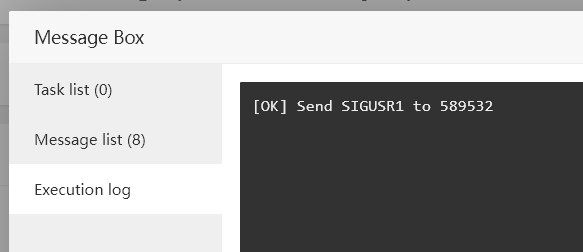

For example, this bug is funny 1-2 years minimum there:
You open PHP and open the SSL

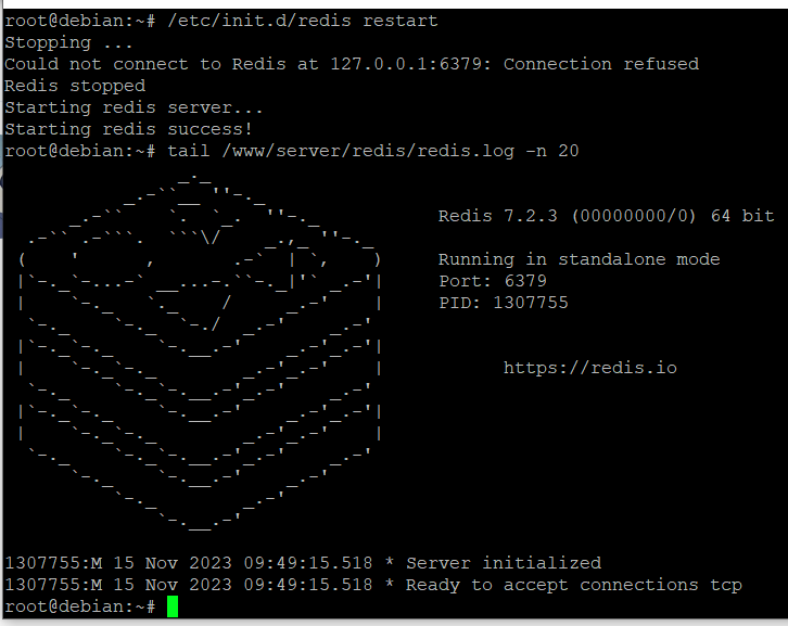

It is recommended that you start from the command line, check what is the reason, and provide redis run log at the same time
/etc/init.d/redis restart
tail /www/server/redis/redis.log -n 20

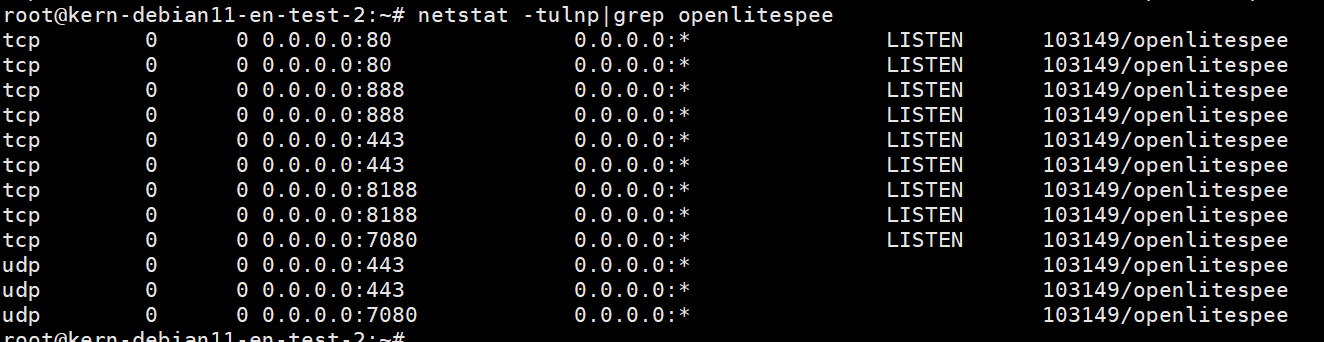

Advice Not Listening Advice Try restarting openlitespeed, other VPS Do you check if there are other programs using port 443? if it cannot be resolved, The server makes a snapshot backup. first, if possible, please send it to kern@aapanel.com.

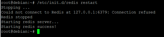

2.) Redist start with parameters work:
Play icon, all okay. When you click restart in aaPanel, ERROR:

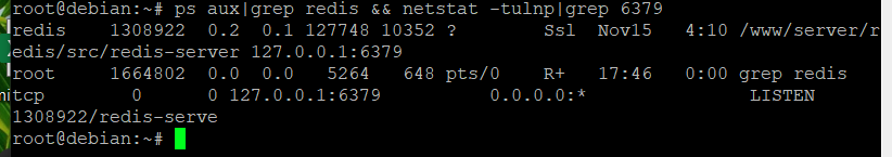

Hello, execute this command to check whether it is running and listening on the port?
ps aux|grep redis && netstat -tulnp|grep 6379

Installed 3 more VPS today, all Redis is paused and still there the bug... Only restart with cmd line work (but I think after restart the VPS again paused).
