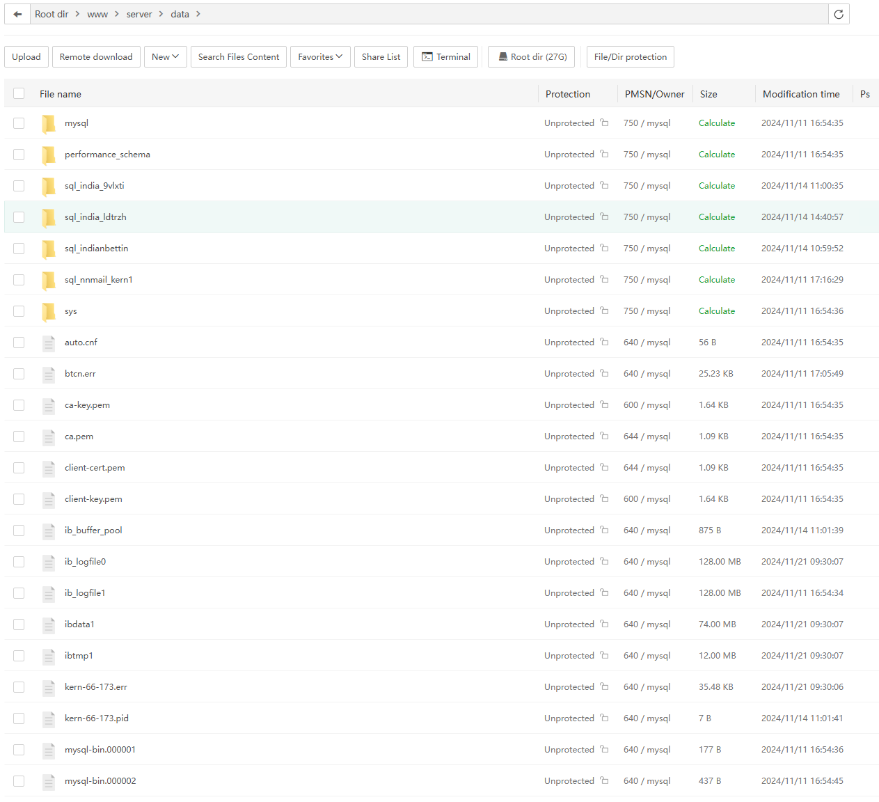

Hello, have you modified the permissions of the directory or file? Or what operations have been done?
Check the permissions of the /www/server/data directory and files
