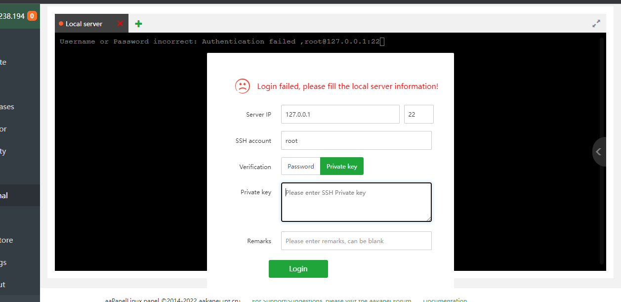

Hi,

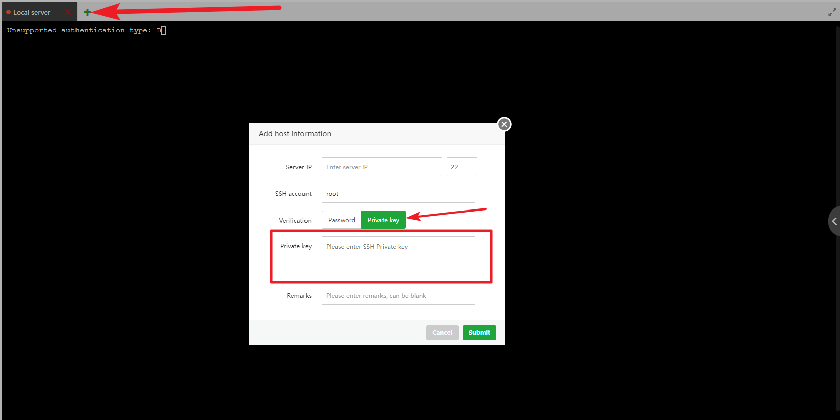

I disable root (login & PasswordLogin) through Putty and this caused the aaPanel Terminal to be disabled I believe because I blocked root login. So I saw that you have the option to create a new Terminal where you add the SSH Private Key which is what I have now to login in Putty but my issue is I don't want to upload the Private key in the server as some could steal it I think and doesn't give a lot of peace, so my question is:
If I add the "Private Key" to create a new Terminal will it be safe?
Which one is the safest way to have Terminal enable on aaPanel when the root is disabled?

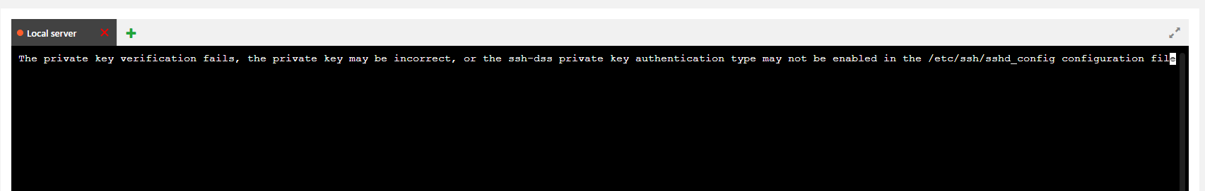

    Is that method to use the Terminal with my (SSH Private Key + passphrase) generated in Putty?
    Because is not working for me,

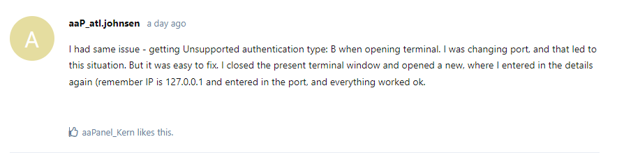

    We have the same issue as here:
    Link

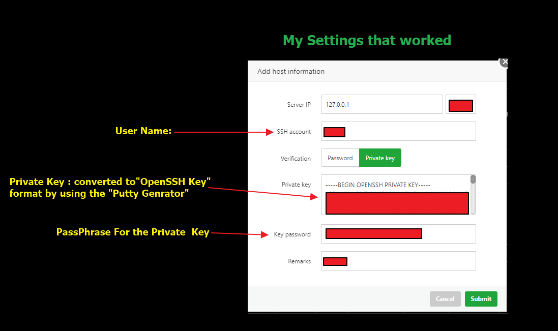

    Im gonna leave my solution that worked here for future references:
    I finally got it to work after years of trying ))
    There were two problems:
    1-The IP I was entering the Server IP 192.85,46.... but never worked and I stumbled in one comment today that mentioned to enter instead 127.0.0.1
    And it worked

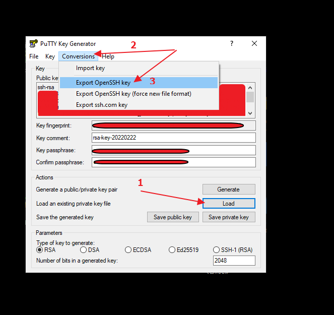

    2-Also, my Private key was RSA so aaPanel doesn't accept it, so I had to convert it to an "OpenSSH Key" format by using the "Putty Generator" and it worked finally:
    I have been years trying (on & off) but never worked till today changing those two things.
