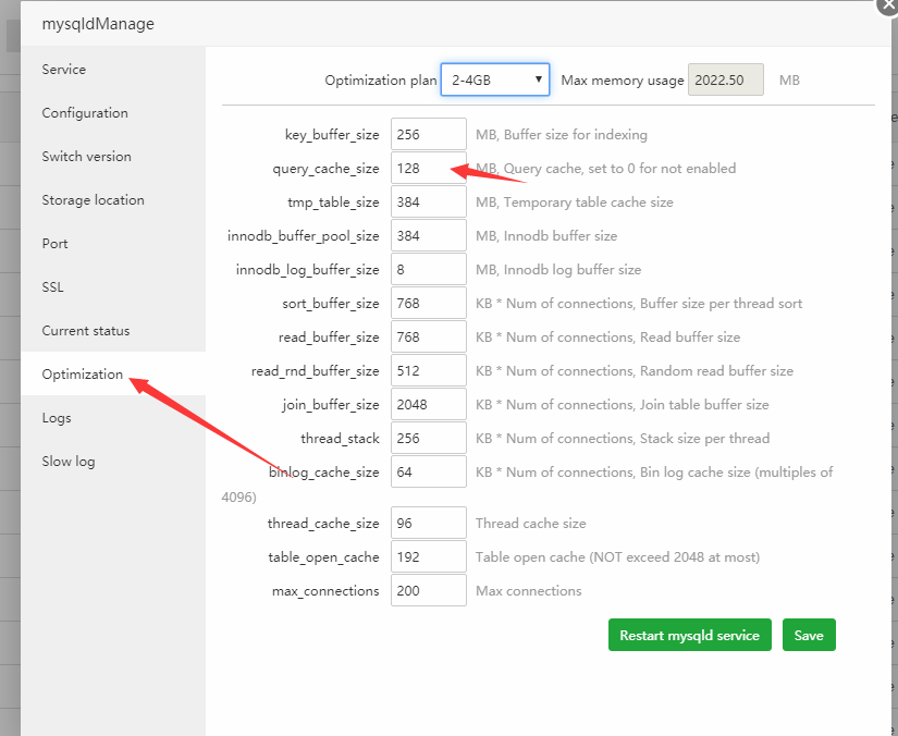

    I have changed it back to nginx 1.18, php7.4 and mysql5.6 using centos 7. how do I install database query cache?

      you can set database query cache here
      Thank you, it’s correct that you have to restart the service after making the change to database query cache to 128? Is 128 a fair value to use for a small 1mb 1 cpu server. Any other good settings for small servers.

        We have recommended solutions, please check the top of the screenshotOptimization paln
