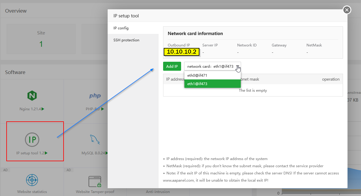

I don't know since when, but aaPanel now support multi IP for: CENTOS7/DEBIAN10/UBUNTU18/UBUNTU20. In App Store there is:
IP setup tool 1.2 official Network card binding IP,Support system:CENTOS7/DEBIAN10/UBUNTU18/UBUNTU20
But still error when I add IP.
aaP_kotakomputer.ceo
Hello, it has been tested that it is not supported to change the ip of the system established in the lxc container.
aaPanel_Kern thanks for you info. Hope in the next version aaPanel support Add IP on LXC (like CPanel does).

Hello, can the plugin support Ubuntu 22.04?
Hello, it is not supported. If you add an IP, it is recommended that you make a backup and then add it manually, or ask the server provider to handle it for you.
aaPanel_Kern Thanks I added it manually and it works and I tested it while adding a new Subdomain.
