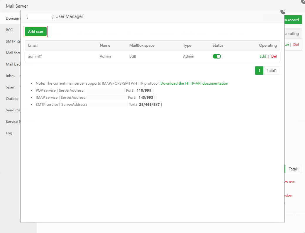

        I just installed roundcube for email, but I can't login. Where to register a new email account?
          Ohh sory, an now Login Failed, where do I see the login password ? Please
            I can send email but I can't receive it in the roundcube, what can it be? Already set up the email server and everything is ok

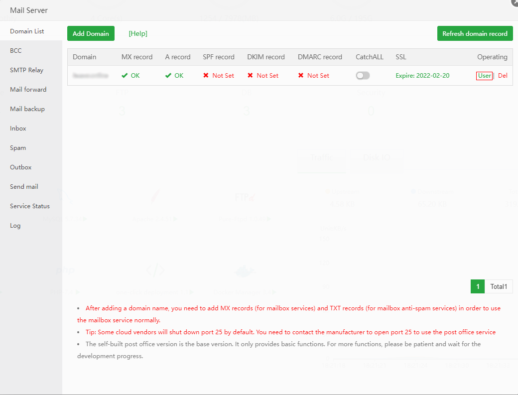

              hi sir
              i installed an aapanel only for RC webmail server.
              the problem im facing is that when i'm trying to add domain name to mail server i got an error "A record parsing failed"
              how can i solve this??
              the other problem is i cant login into RC because i dont know whats the user and password
              server address
              mail.pardisjam.net
