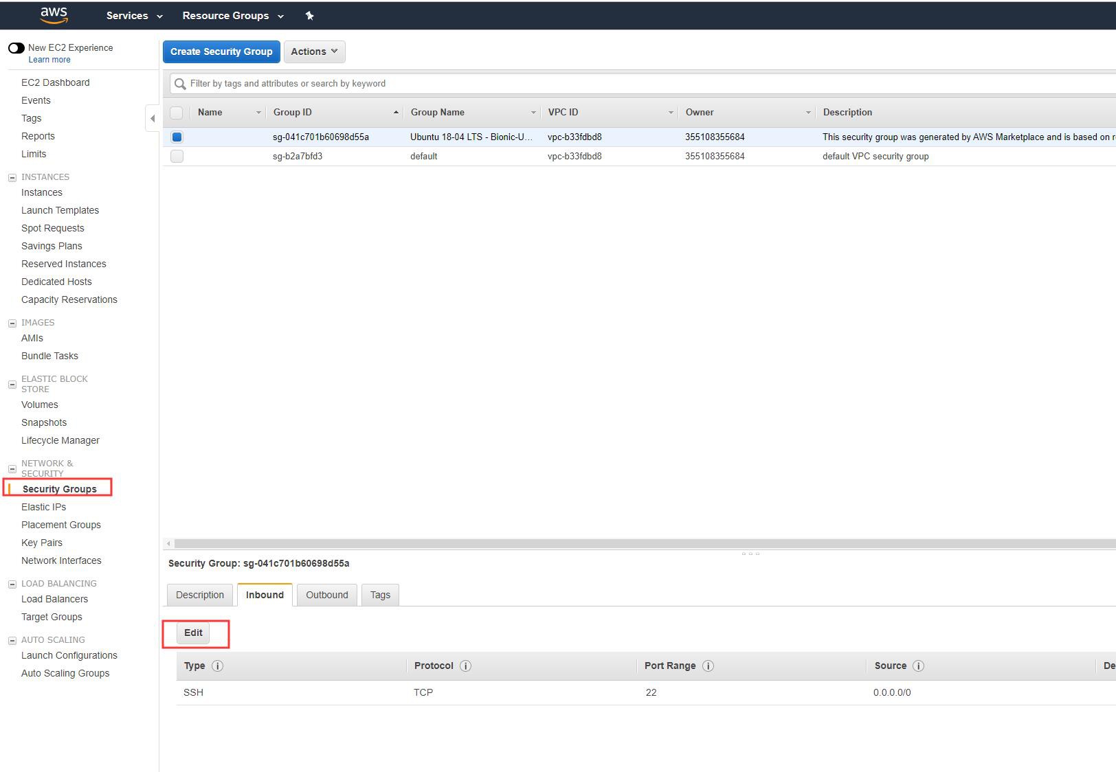

Panel is inaccessible after installing the panel.
The panel cannot be accessed after modifying the port.
Log in to your aws console, Find your security group settings, Make more screenshots to do the following settings

    Hello aaPanel_Jose I have successfully installed aapanel, but it gives me the following access data:
    aaPanel Internet Address:
    aaPanel Internal Address:
    Warning:
    If you cannot access the panel,
    release the following port (8888|888|80|443|20|21) in the security group
    I released it as shown in the screenshot below, but still without access to the panel: /
