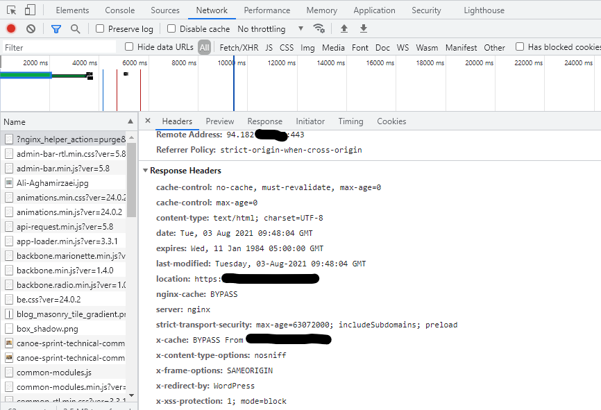

    Hi, I found some issues on my website using this fastcgi cache.
    First I get duplicate response header on my https://example.com/page1, see image.
    If I refresh 2x, that will duplicate 3 times, I dont know what happend.
    Issues number two I getting issues Parse error: syntax error, unexpected 'define' (T_STRING) in /www/wwwroot/example.com/public_html/wp-config.php on line 7
    I dont know what happend, another page work just one page give me that error.

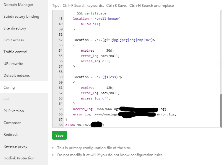

      aaPanel_Jose
      When I copy the config file from here to my server , I got this error :
      I add my ip address in allow "change_to_your_server_ip"; and in /www/server/panel/vhost/nginx/mysite.com.conf:68
      second question : I'm running php 8 , is need to change 73 to 8 ?
      in this line :
      fastcgi_pass unix:/tmp/php-cgi-73.sock;
        Now the config saved whiteout error but in testing with browser, I couldn't find any FastCGI cache
