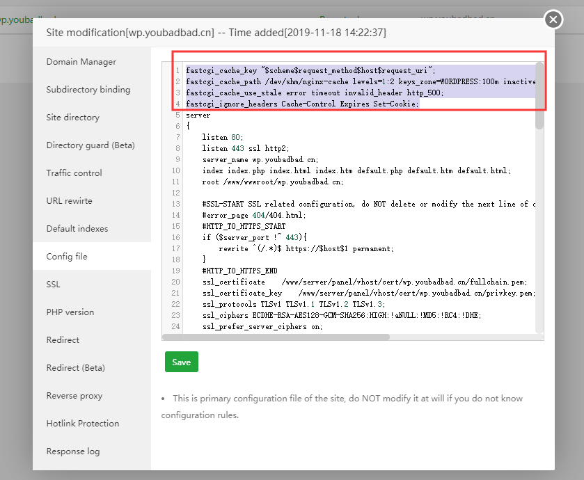

  1. Add the following 4 rows to the top of the site configuration.
    fastcgi_cache_key "$scheme$request_method$host$request_uri";
    fastcgi_cache_path /dev/shm/fastcgi-cache levels=1:2 keys_zone=WORDPRESS:100m inactive=60m;
    fastcgi_cache_use_stale error timeout invalid_header http_500;
    fastcgi_ignore_headers Cache-Control Expires Set-Cookie;
  2. Create a cache directory
    mkdir /dev/shm/fastcgi-cache

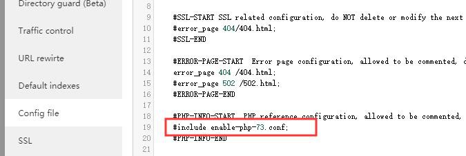

  3. Comment php configuration

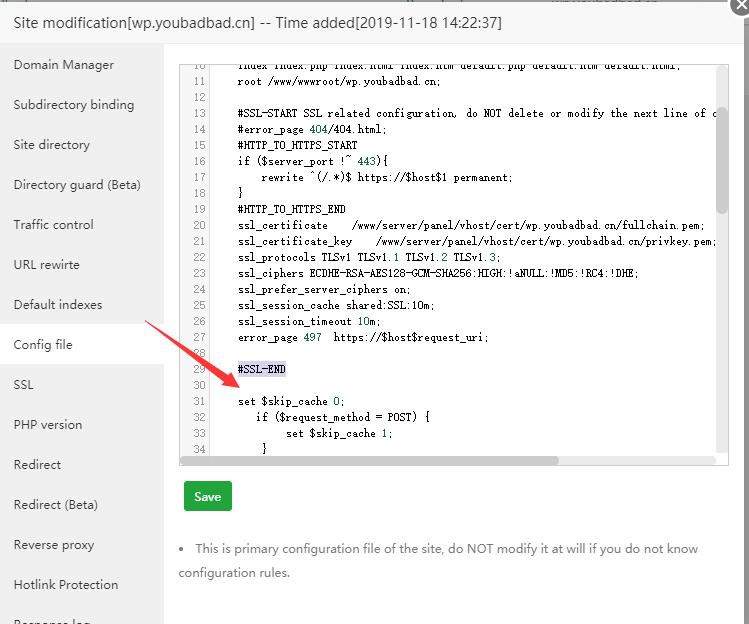

  1. Add the following to the server field
    If you have ssl turned on, add it below #SSL-END

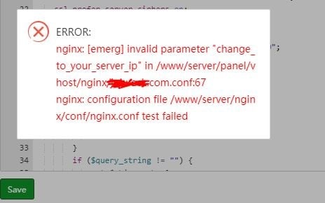

            allow "change_to_your_server_ip";

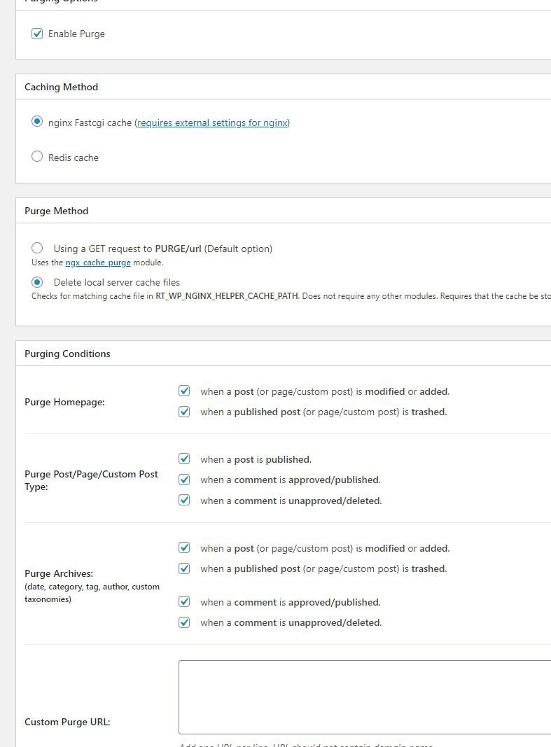

  1. Install and configure the (Nginx Helper) wp plugin.
  2. Since the cache path defined by the plugin author is /var/run/nginx-cache , we may customize the cache path according to the actual situation of the server. As a result, the difference of the cache path will cause the plugin to not find the cache file and delete it!
Add the following code to the WordPress wp-config.php file

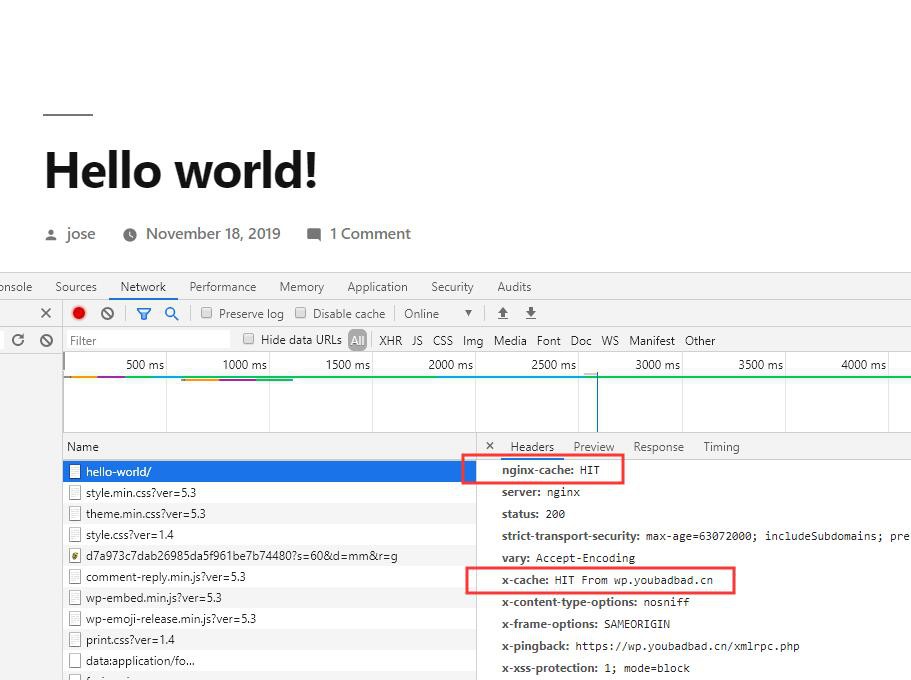

  1. Check whether the configuration takes effect

    This is working, however the PURGE does not clear the cache. I have had to manually remove the files from this path to clear the cache:
    Also let me know, why do we need to comment out PHP Conf files. I am using PHP 7.2 & Nginx 1.16, will there be any difference?
    aaPanel_Jose
    In point number 6 we need to use this code and path to wp-config.php, and then PURGE button of nginx helper will work.
    define('RT_WP_NGINX_HELPER_CACHE_PATH', '/dev/shm/fastcgi-cache');

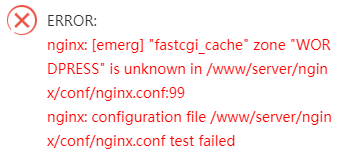

    When I want to duplicate this procedure on multiple websites, what approach should be used? Since it is giving error message while saving config on another website.
    nginx: [emerg] "fastcgi_cache_key" directive is duplicate
      can you make this as addon or default in next upgrade as cache is most require for wordpress sites
        szone
        So if we need to use fastcgi caching on multiple sites, we need to follow this process: (you need to skip step number 1 from above guide)

                1. The first 4 lines of files added by nginx are fastcgi cache configuration, they are safe
                2. Please do not add these configurations to nginx.conf, add them to the website's configuration file
                3. Even if there is no SSL, there will be # SSL-END comments in the website configuration
