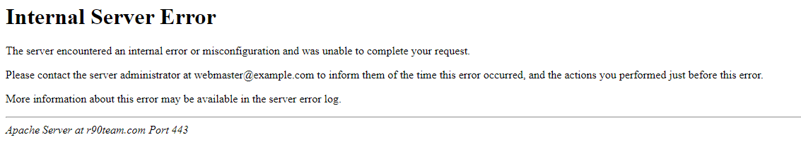

error 500 after install, OS: Debian10, Apache
slymer Hello, website 500 internal server error, troubleshooting site log analysis.
The site log is in the / www / wwwlogs directory by default.
slymer tathanhsonofficial
Please update the version to 5.1 or reinstall the plugin to solve it
aaPanel_Jose
is currently version 5.1 but still has the same error
tathanhsonofficial
Sorry, we have just tested that there will indeed be problems with the installation of the debian system. We can arrange to refund you or replace it with other plug-in coupons. What do you think?
