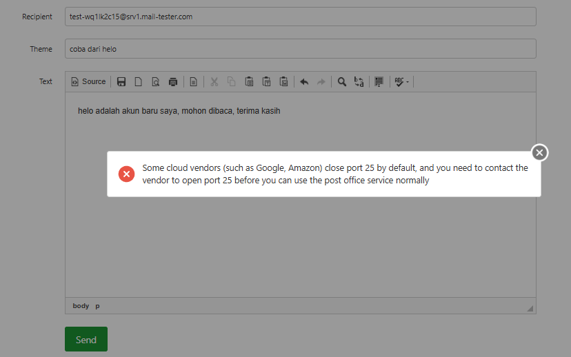

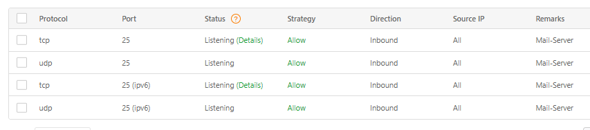

    Same problem here after update... and the problem same at fresh aapanel too... the error same like in image capture...
      Hello, please check if your server can connect to port 25 of gmail? If not, maybe your server does not allow connections to port 25 of other servers.
      If you cannot connect to port 25 of other servers, you cannot send emails.

      aaP_pancadewa
        Trying 74.125.200.27...
        Trying 2404:6800:4003:c05::1a...
        telnet: Unable to connect to remote host: Network is unreachable
        What should i do ?

            Wow, thank you, it turns out that port 25 on my VPS has not been opened by the service provider, and now it is running well.
