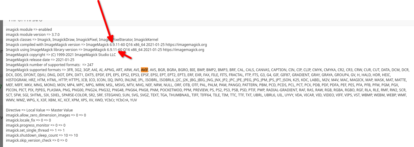

Using imagick extension, PHP itself does not need to be compiled with AVIF support.
What matters is whether your ImageMagick installation supports AVIF, and that your Imagick PHP extension is linked to that ImageMagick.

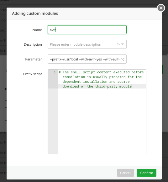

aaPanel_Kern Thanks for the support, I managed to enable it. But there is another situation, my server is arm and it didn't work for me, but for AMD it was perfect, thanks again and keep up. I've been using the panel for years and for me it's the best.
