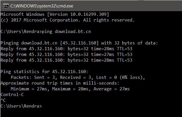

keperluanlain005
please run "ping download.bt.cn
" and give me the result
- Edited

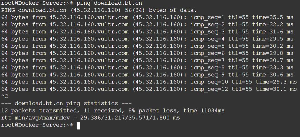

Thats the result
This one from my aaPanel server

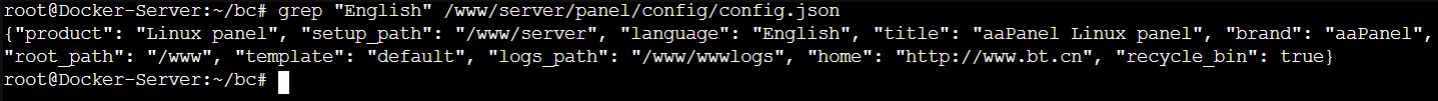

keperluanlain005
I am checking the file of this node is correct, run this command to see the results?
grep "English" /www/server/panel/config/config.json
This the results
