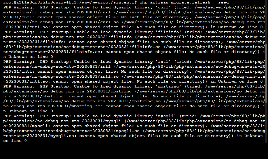

Hello, i have an issue when i deploy my laravel app in my vps, it has some issues that the extensions is not available or cannot be loaded
like
-mbstring
-openssl
-curl
-pdo_sql etc,
i have installed it at panel app store
i try all php version and it keep return same error

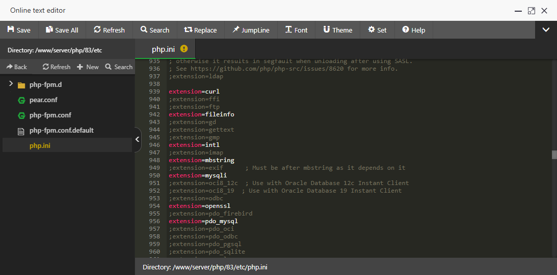

this is my php.ini at /www/server/php/83/etc
and when i try it
i had surfing at another forum but there is no one that have it fixed, and when i look at Install Extension menu at settings php, i can't find specific extension that i needed... (except mbstring and intl), and curl is default extension that should included in installed php, but it keep return error cannot loaded the curl extension...

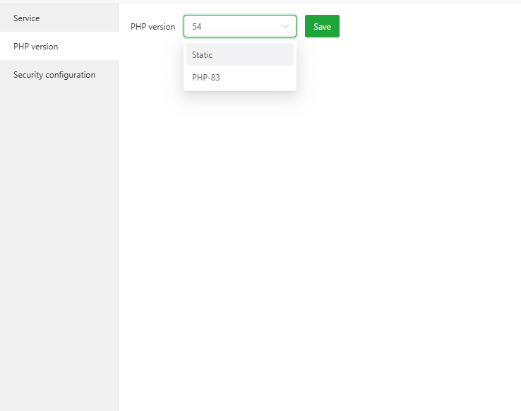

uh i forgot the phpmyadmin, it keep return 405 not allowed
there is some forum that have changed the php version, and when i change it, the version keep back to 54
    Hello, do not enable these extensions directly. You can go to the Install Extension interface to install mbstring. Other extensions are enabled by default. You can check PHPinfo.
    There should be a display problem with phpmyadmin. Is it normal to try restarting the web service? Also use the browser in incognito mode to access
