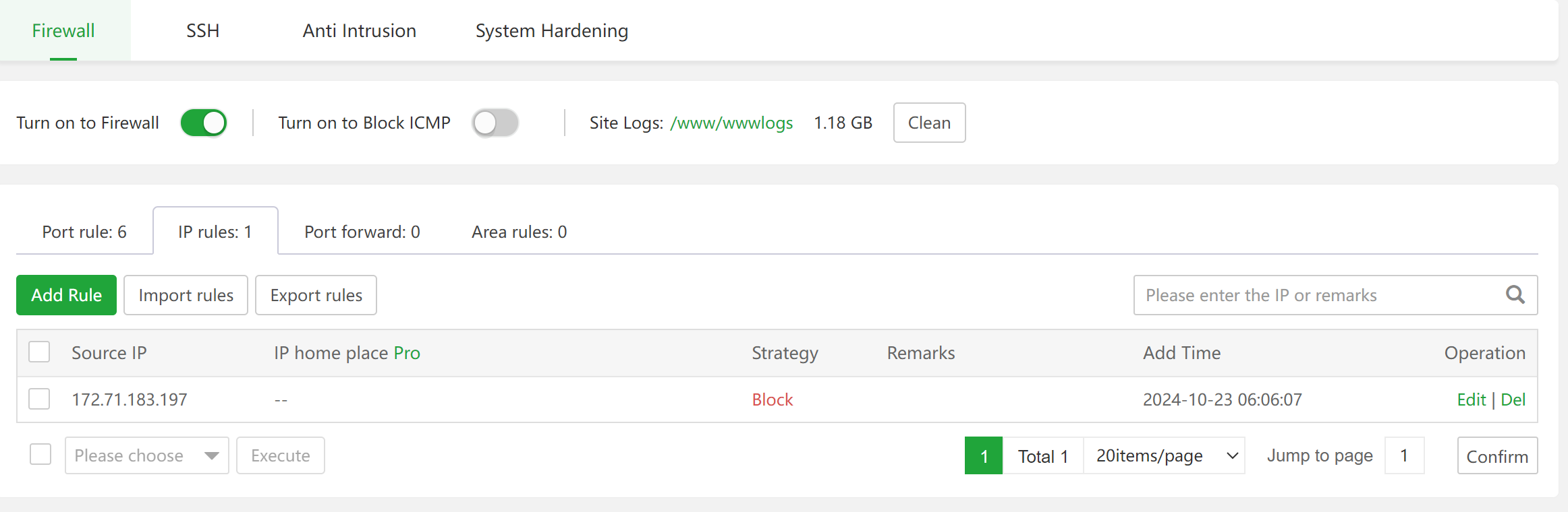

I tried blocking here and they didn't work
and here too

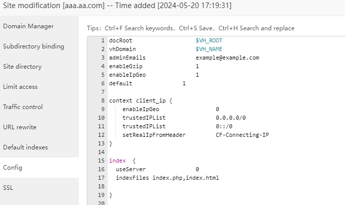

It is recommended that you enable CDN identification matching
context client_ip {
enableIpGeo 0
trustedIPList 0.0.0.0/0
trustedIPList 0::/0
setRealIpFromHeader CF-Connecting-IP
aaPanel_Kern Where should I add this code, or where should I turn it on? Please guide me
Just add it to the site configuration. After the addition is complete, restart Openlitespeed.

aaPanel_Kern Specifically, where is it? Can you take a screenshot for me to see?
Do you mean add it here?

aaPanel_Kern I added it and where can I see the log?
here
I don't see any changes, the log still appears as before
I found his ip address, but when I block the ip, it automatically changes the ip and I check all ips are from this provider.
https://www.whois.com/whois/185.162.11.230
Is there any way to block it?
sanhpv if You're using cloudflare, then You can try to create WAF and block the IPs/Country or ASN from CloudFlare.
Also, if You're targeting specific countries only, then You can create WAF in CF to allow those countries only.
note: don't forget to allow Google ASN if You want to allow specifics countries.
- Edited
Hello, you can try adding a network segment such as:
185.162.11.0/24
or
185.162.0.0/16
