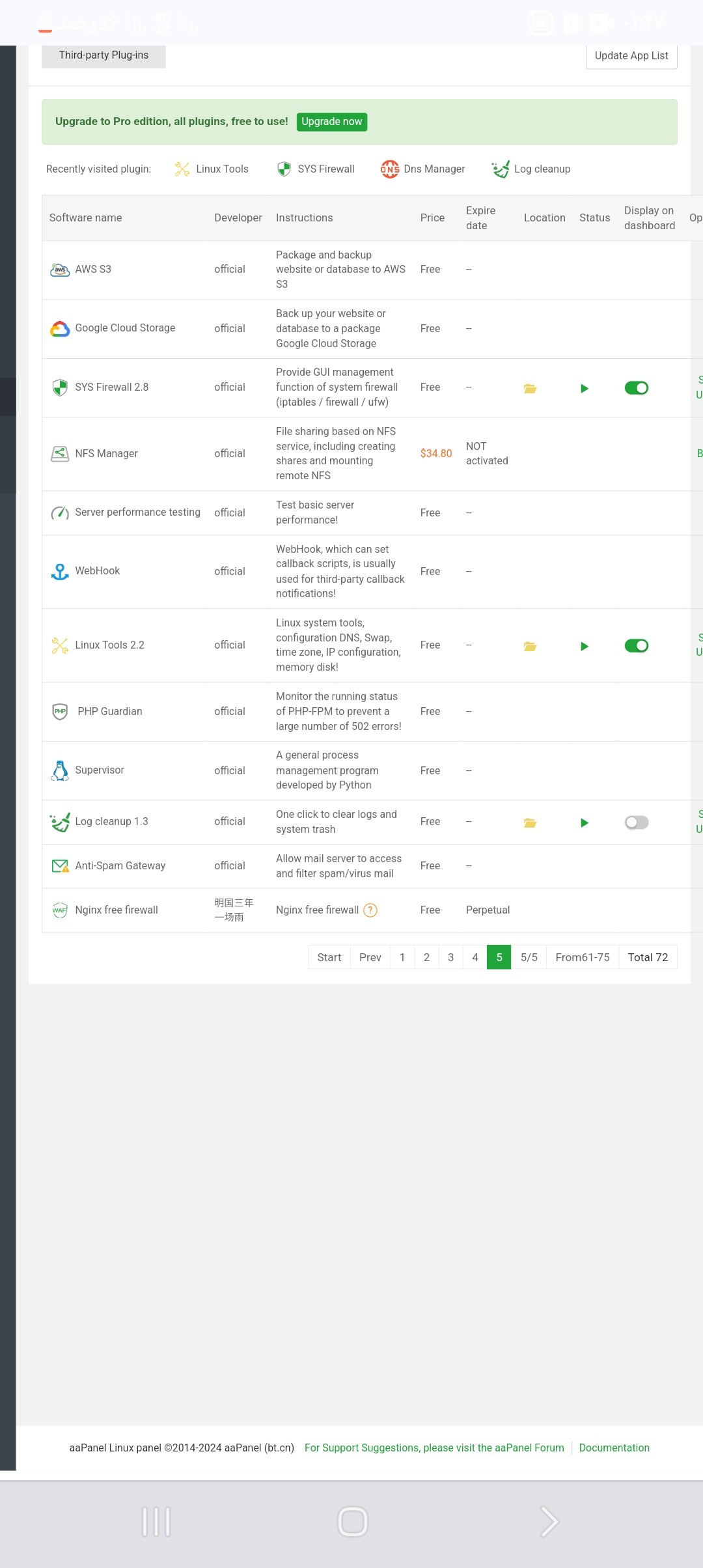

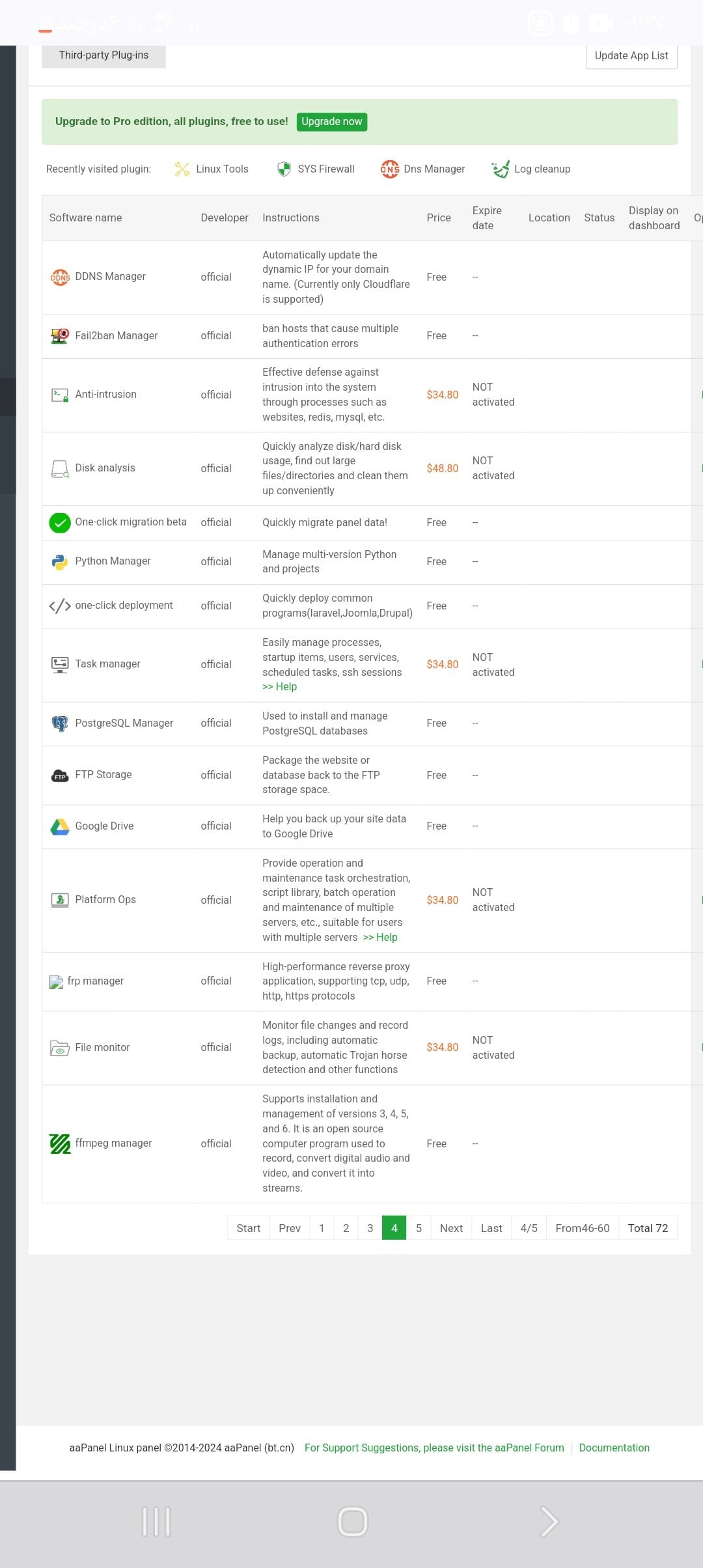

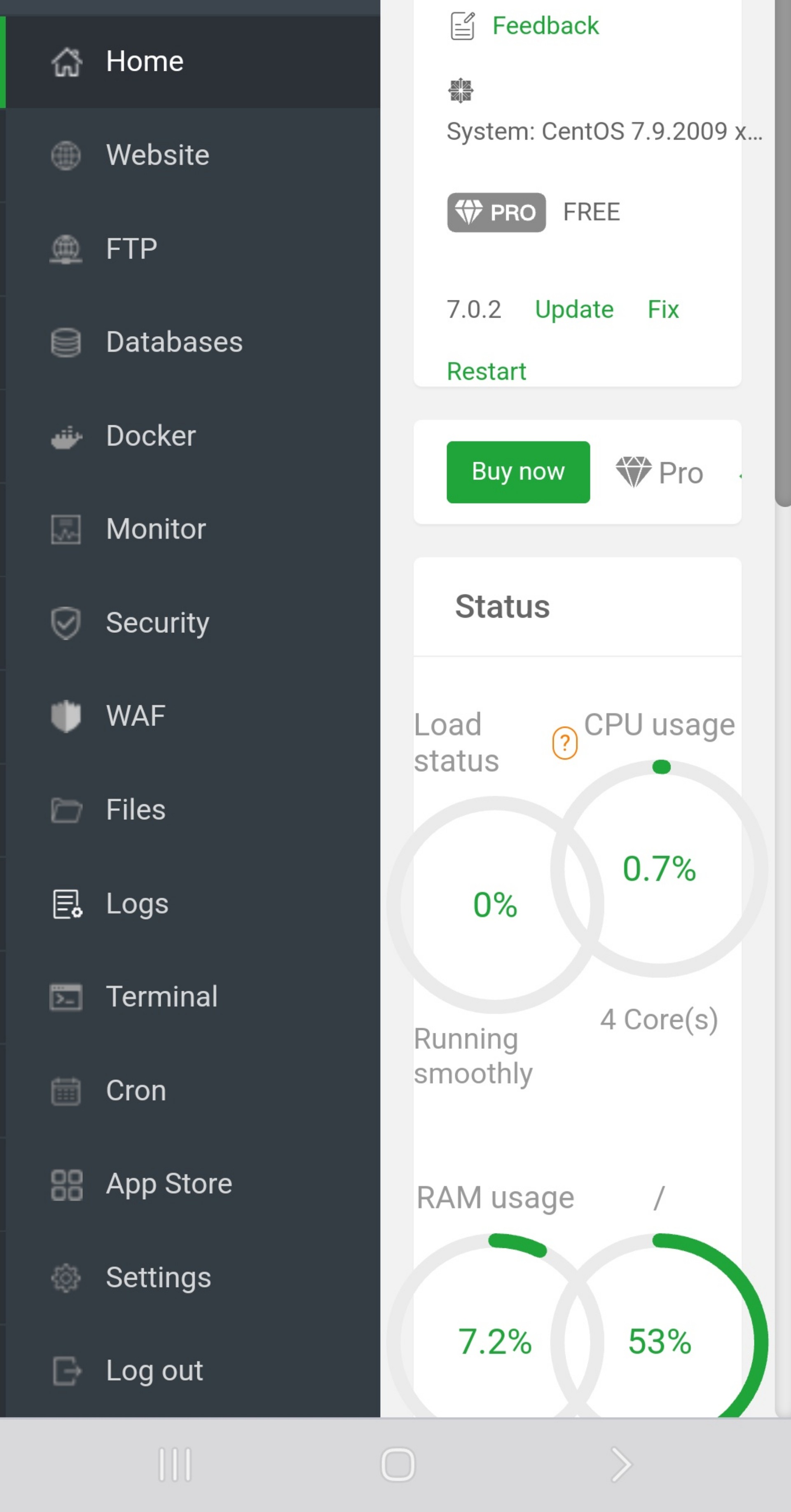

              Hello
              I used to use mobile phone all the time, now it is very broken, nothing is in order
              There is no install button
              In some plugins
              In desktop mode, there are no buttons on the phone
