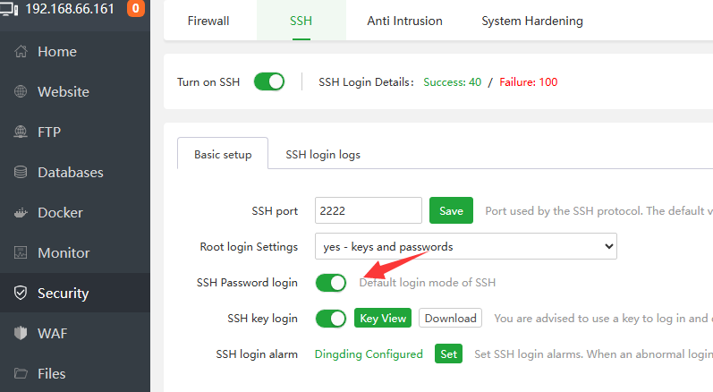

Hello, if you are using a password to log in, please check whether this option is turned on.
aaPanel_Kern i already did that
