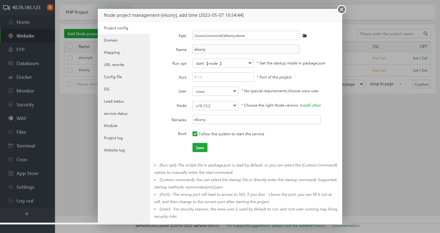

failed to activate
start > node . Running cleanup before exit. > start > node . Running cleanup before exit. > start > node . Running cleanup before exit. > start > node . Running cleanup before exit.
failed to activate
aaP_mohamedeldony3
Hi, is it working fine trying to run with the command?
This looks normal. Is it the same as recommending that you run it using the command line?
The node path of the panel, please use the full path: /www/server/nodejs/v16.14.0/bin/
Replace v16.14.0 with your node version
aaPanel_Kern What do you mean
aaPanel_Kern I'm following someone else's steps and it worked for them and it won't work for me
Are they also built using aapanel? Is there a link?
Also check your settings are correct? Are there other options for Run opt, and if so, is it normal to choose others?
try to use the custom command "pm2 start app.js". I try to add pm2 and it works
