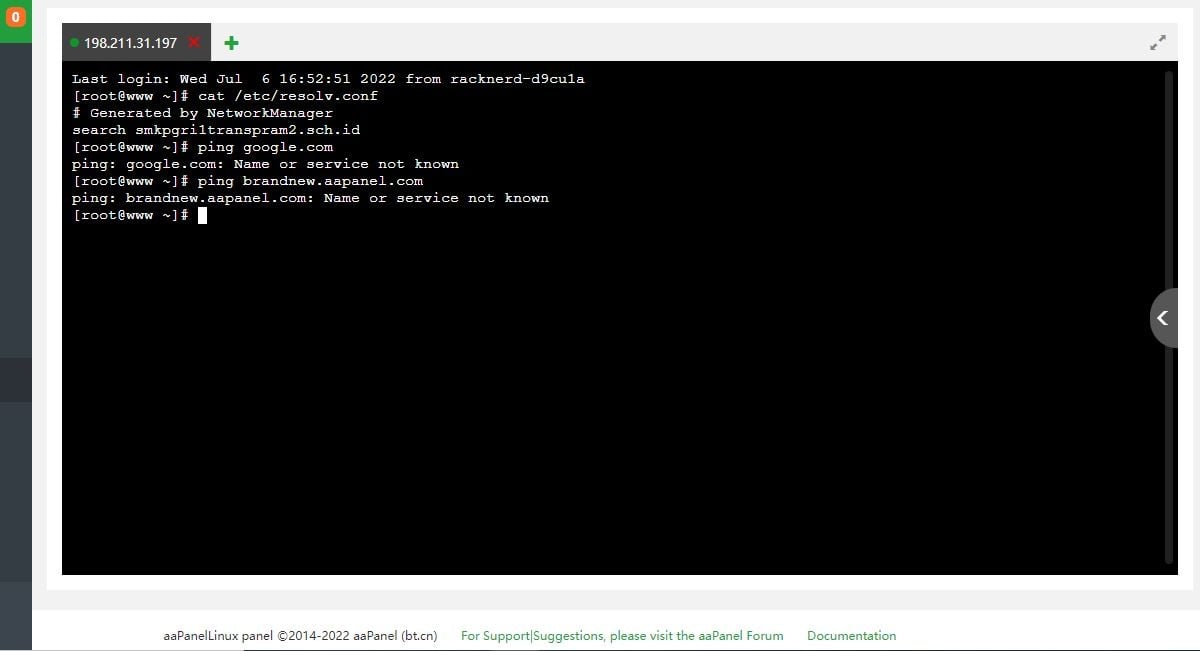

This is caused by the abnormality of your server network.It is necessary to check whether the network of the server is normal, and check whether the DNS server is set.
Use the ssh tool to execute the following two commands:
cat /etc/resolv.conf
ping google.com
ping brandnew.aapanel.com
i can't add domain in dns manager aapanel
- Edited
aaP_irwanirmawan1996

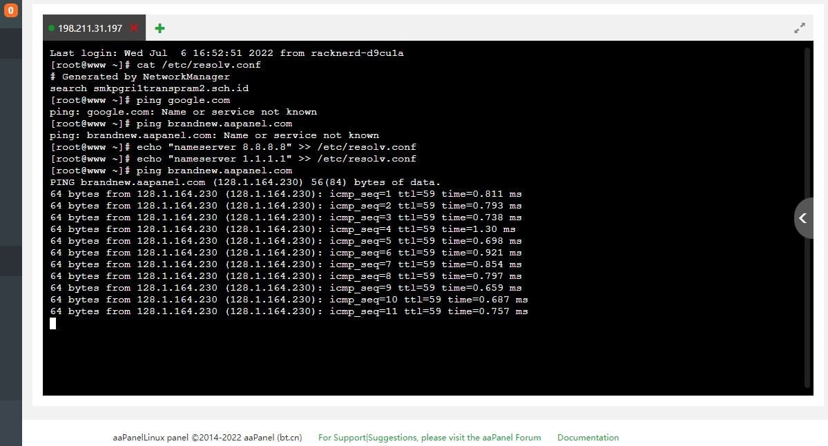

Execute the following command to set the nameserver:
echo "nameserver 8.8.8.8" >> /etc/resolv.conf
echo "nameserver 1.1.1.1" >> /etc/resolv.conf
okey reply.. And then ?
