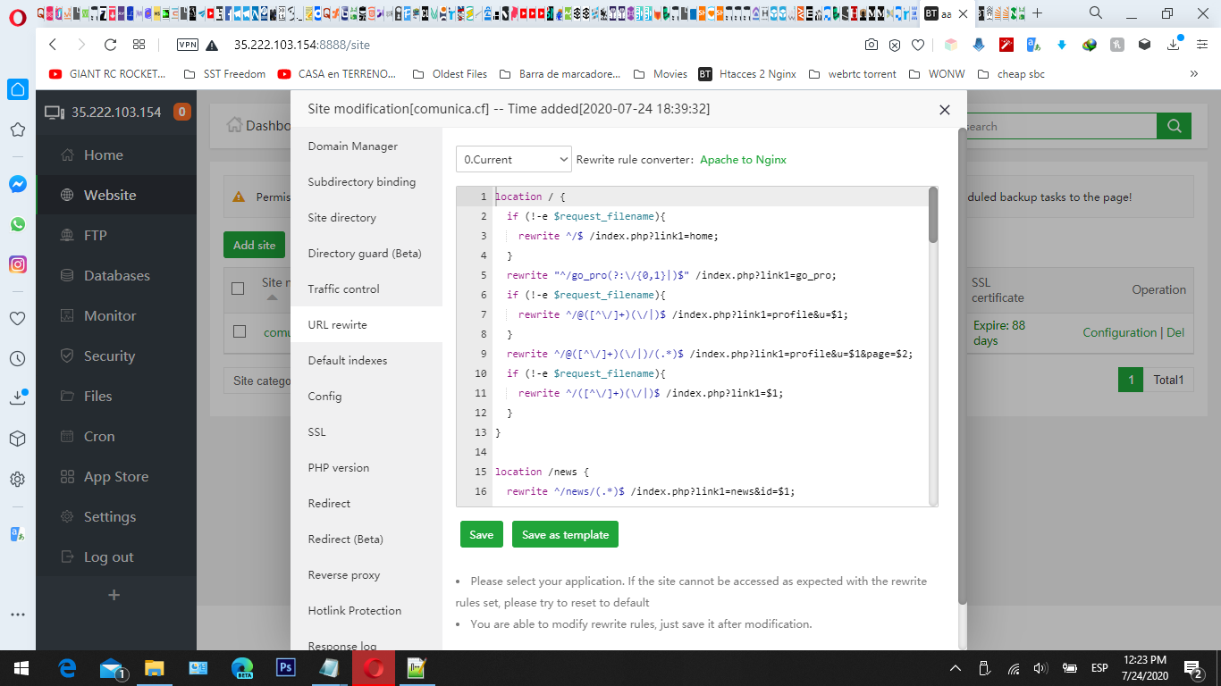

Again in aaPainel, go to WEBSITE choice you site. In configuration, URL REWRITE and add:
location / {
try_files $uri $uri/ /index.php?$args;
Save.
