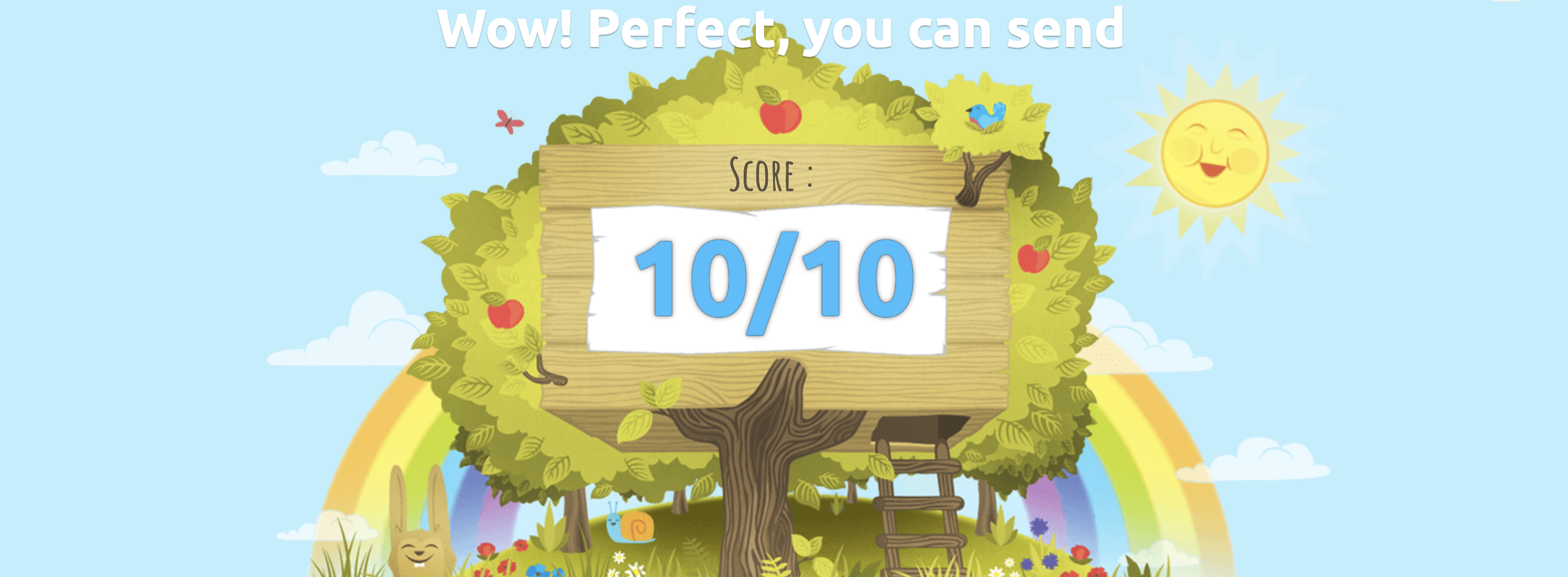

lordthall Hello , I have an email address for a domain Gamemail.eu, I've got 10/10 points on a mail test, I use SSL but nevertheless e-mails we send to @gmail.com keep appearing in spam folder

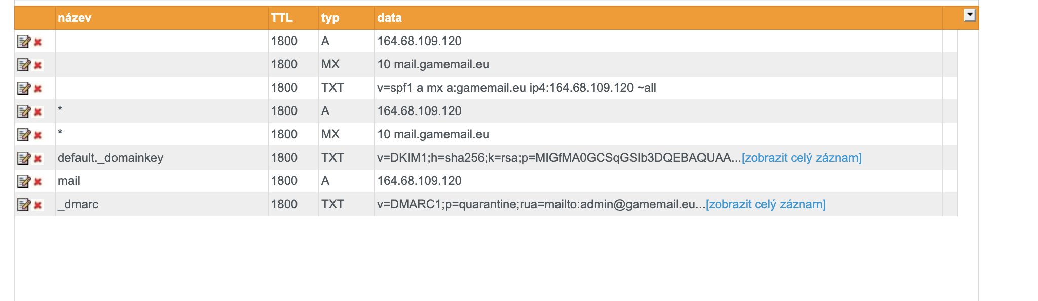

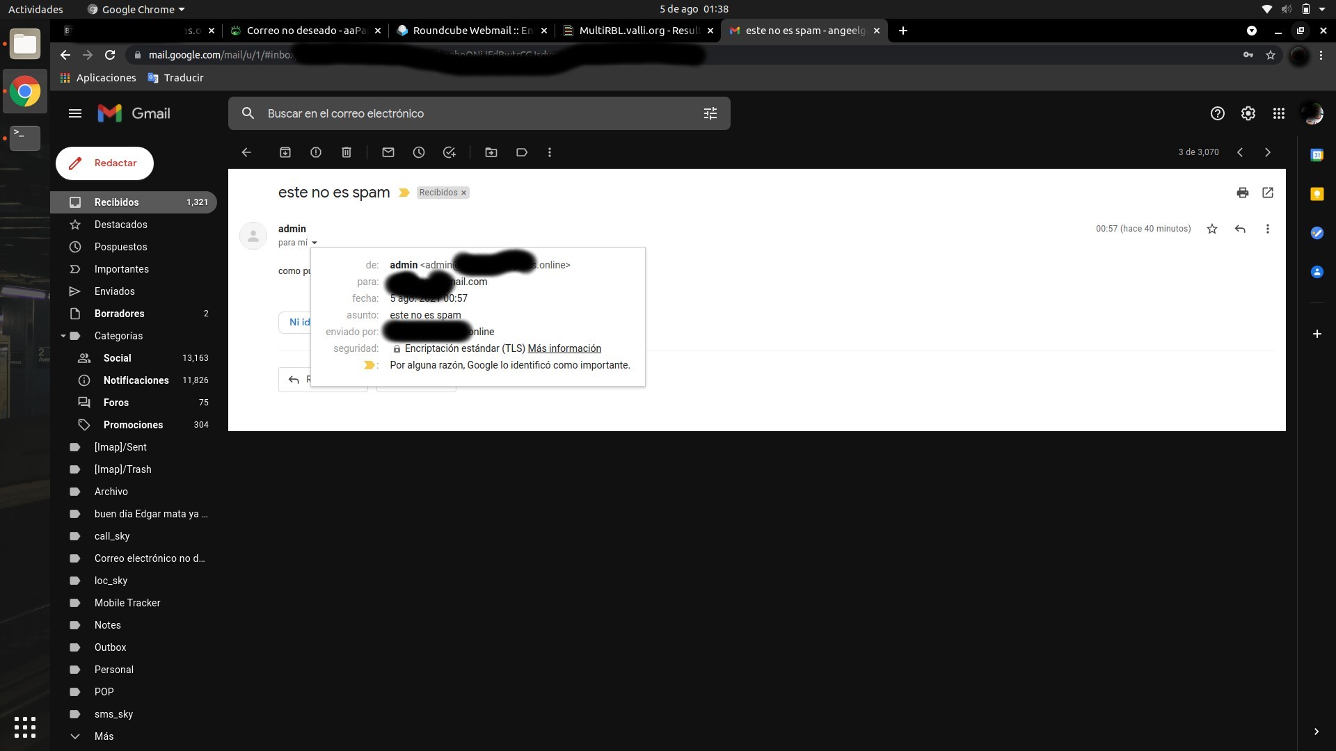

angeelgar Stealth es necesario verificar la propiedad del dominio con un registro txt que google proporciona si tu servidor tiene ipv6 tambien es necesario agregarlo al spf record dado que aapanel da preferencia a ipv6 cuando esta disponible y si tu ipv6 no esta registrada da softfail https://support.google.com/mail/answer/9981691?hl=es- este dominio no tiene un ssl valido https://www.abacus.bcs.edu.bz/login/auth necesitas verificar la reputacion de tu ip https://spameatingmonkey.com/ https://multirbl.valli.org/lookup/ Nmap scan report for vmi431081.contaboserver.net (164.68.109.120) Host is up (0.17s latency). Not shown: 842 closed ports, 142 filtered ports PORT STATE SERVICE 21/tcp open ftp 22/tcp open ssh 25/tcp open smtp 53/tcp open domain 80/tcp open http 110/tcp open pop3 143/tcp open imap 443/tcp open https 465/tcp open smtps 587/tcp open submission 993/tcp open imaps 995/tcp open pop3s 2222/tcp open EtherNetIP-1 8080/tcp open http-proxy 10000/tcp open snet-sensor-mgmt 20000/tcp open dnp en este caso hablo de mi experiencia y me a funcionado
