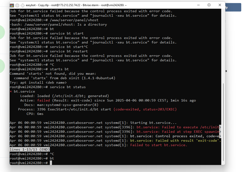

    root@vmi2424280:~# service bt status
    Γ— bt.service
    Loaded: loaded (/etc/init.d/bt; generated)
    Active: failed (Result: exit-code) since Sun 2025-04-06 00:00:59 CEST; 1min 16s ago
    Docs: man:systemd-sysv-generator(8)
    Process: 3396 ExecStart=/etc/init.d/bt start (code=exited, status=203/EXEC)
    CPU: 6ms
    Apr 06 00:00:59 vmi2424280.contaboserver.net systemd[1]: Starting bt.service...
    Apr 06 00:00:59 vmi2424280.contaboserver.net systemd[3396]: bt.service: Failed to execute /etc/init>
    Apr 06 00:00:59 vmi2424280.contaboserver.net systemd[3396]: bt.service: Failed at step EXEC spawnin>
    Apr 06 00:00:59 vmi2424280.contaboserver.net systemd[1]: bt.service: Control process exited, code=e>
    Apr 06 00:00:59 vmi2424280.contaboserver.net systemd[1]: bt.service: Failed with result 'exit-code'.
    Apr 06 00:00:59 vmi2424280.contaboserver.net systemd[1]: Failed to start bt.service.

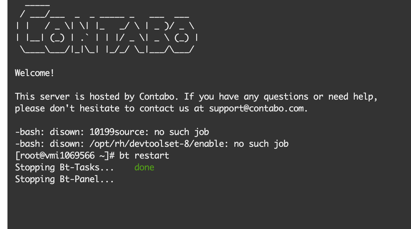

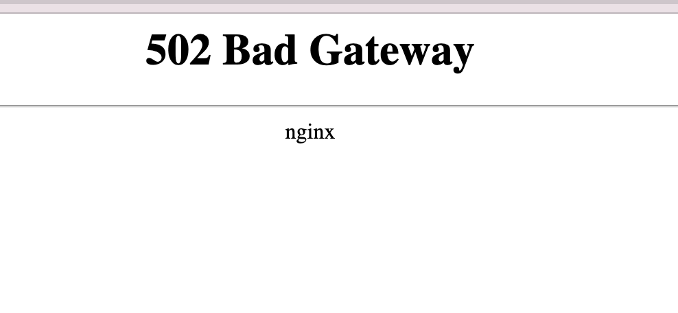

    after update to last beta version i get a lot of spamming emails and after checking semilar issue happen to me i tried to solve the issue so i start testing bt restart but as it mention on the screen shot keep loading and then lost access to panel and showing like the second screenshot
    i'm facing email spamming since i start using aapanel maybe i have not that much experince but still almost 7 months same issue
    kindly please if you can suggest me what to do !
