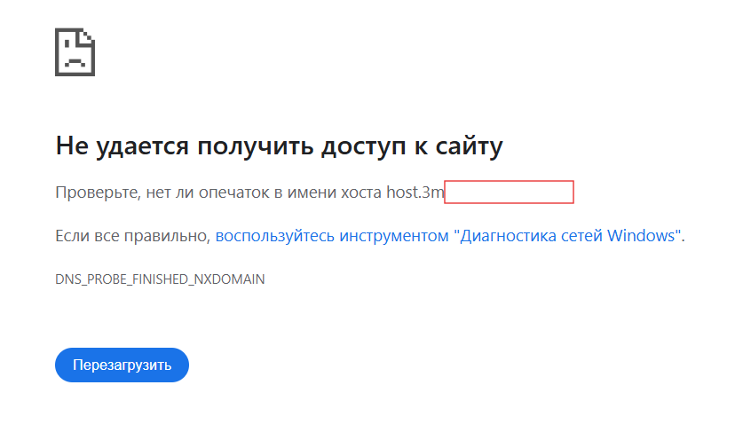

              Hello, please check whether the domain name has an A record and is resolved to the server's IP? Or try to cancel the domain name: bt 12
