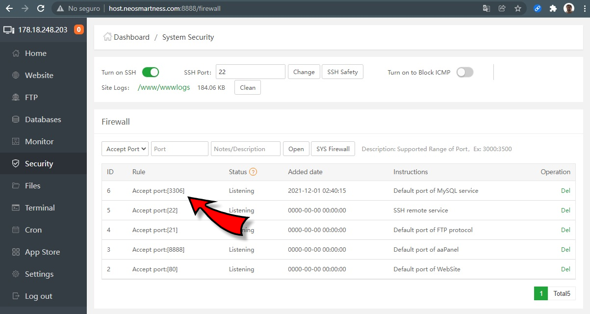

Port 3306 open
![https://www.acahol.com/img/firewall.png]

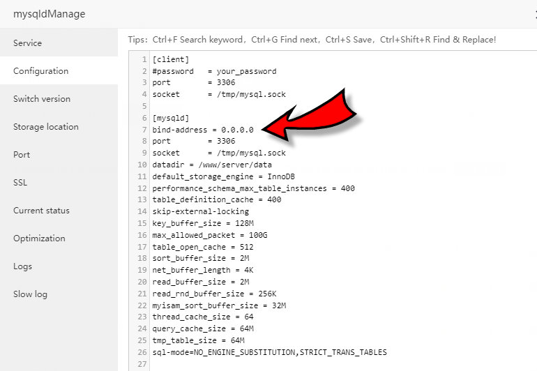

Bind Address 0.0.0.0
![https://www.acahol.com/img/mysql.png]

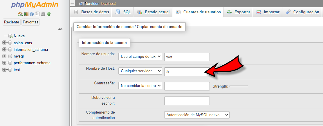

and from phpMyAdmin I created a new user and I also added to root user this host
![https://www.acahol.com/img/phpmyadmin.png]

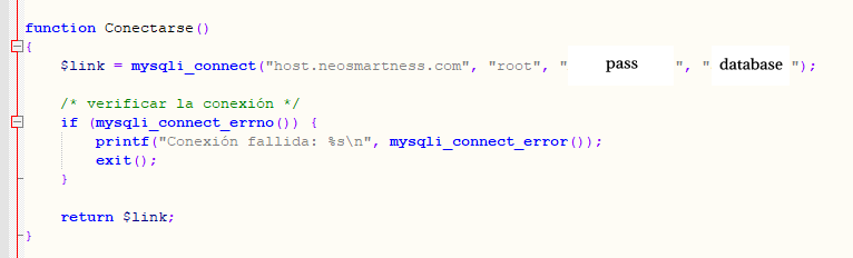

my PHP code is this (work fine using localhost)
![https://www.acahol.com/img/php.png]

    ASLAN Whitelist the MySQL Port 3306 from Firewall, and it will work. 🙂
      ASLAN Install the security firewall plugin and add that 3306 port there. Worked for me that way.

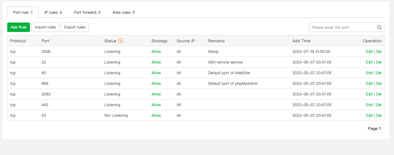

            If not, is the specified IP the IP of the server of the website? Is port 3306 open on the firewall of the server provider?
              I did port open 3306 at website server. and database server also.
              But still cannot access database.

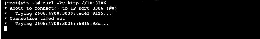

              $con = mysqli_connect("xxxxxxxx","username","password","dyname");
              error message
              Warning: mysqli_connect(): (HY000/2002): Connection timed out in /var/www/lis/html/index.php on line 11
              Failed to connect to MySQL: Connection timed out
                aaP_swe_mayhtike
                Hello, your server cannot connect to port 3306 of the database. It is recommended to check whether port 3306 is open in the security group of the server provider? Is the system firewall open?
