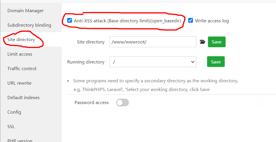

I am using aapanel and got the following error message from a script I am running.
I hope someone can tell me were in the aapanel I should do a modification to solve this error and also what I should type in.

    It worked, thank you!
    If you are installing a new instance, remember to the "fileinfo" extension in PHP.
