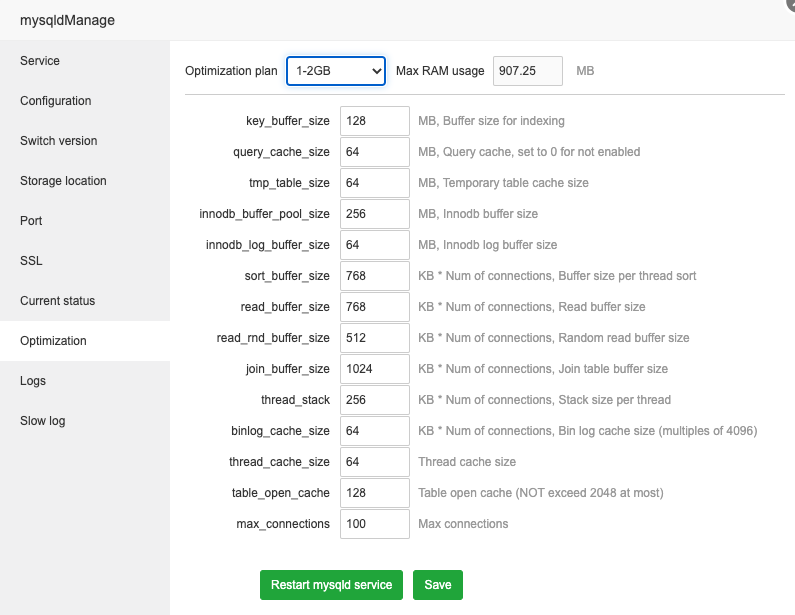

Kisku I just run two websites with low traffic still my cpu usage is too high that sometime the site do not work well. Please help me out my mysql configuration is

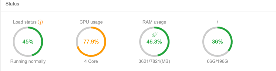

aaPanel_thisyear Kisku Hello, how big is the real physical memory of the server? Take a screenshot of current status.
Turbine What kind of queries are executed in the database? Which kind of software is being ran? Mysql had a query log, you might want to look you could enable: https://tableplus.com/blog/2018/10/how-to-show-queries-log-in-mysql.html

Kisku aaP_lazaroagomez this is my configuration: 4 vCPU Cores 8 GB RAM 200 GB SSD 200 Mbit/s Port 1 Snapshot
Kisku aaPanel_thisyear I upgraded the mysql optimization plan to the highest now everything is looking good.

aaPanel_thisyear Kisku Hello, take a look at the current status and performance adjustment of MySQL How much memory does the server have?

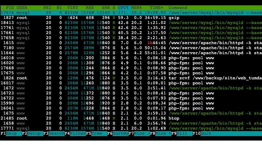

aapanel_power Kisku Kisku Hello, there is a gzip process, is it doing a backup? Will the CPU usage drop after the backup is over?
PhongLy aapanel_power How to stop this process and how can i check how many process are going on is there guideline i am new to aapanel

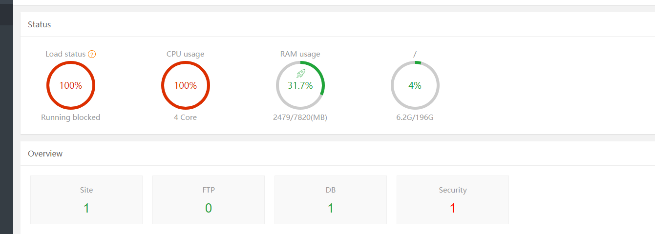

PhongLy hi sir i am having same issue even no cron job is running but cpu usage is 100% how to solve i am new to this aapanel ,and don't have much idea about ![
aaPanel_thisyear PhongLy Hello, the server command line executes the following command to analyze and see what process occupies and consumes yum -y install htop && htop
