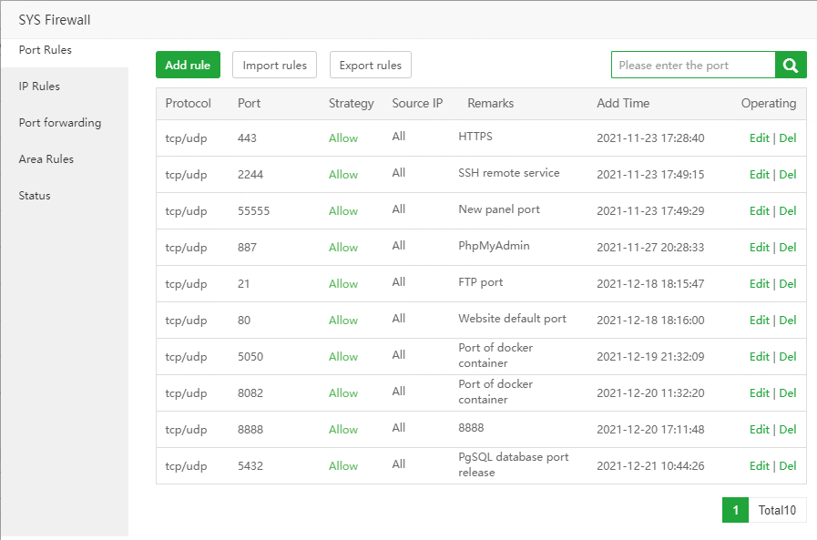

aapanel_power IRBIS Hey, it's like this. When phpmyadmin uses the https url to access, it uses port 887, and http access uses port 888.

aaP_anass Hello, The same thing happens to me as you, I have tried to solve it with all the solutions that you have mentioned before but I can't solve it. Can anyone help me? ERR_CONNECTION_REFUSED
aaPanel_Kern Hello, please check whether phpmyadmin is running, whether the host's firewall opens port 888, and whether the service provider's firewall opens port 888. aaP_anass
