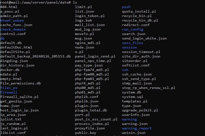

aaPanel_Captain I turned off the panel from aapanel settings, how do I turn on the panel?
aaP_aman_khan221
Log in to the server using the SSH tool and delete the following file: rm -f /www/server/panel/data/close.pl
Is it possible to revisit?
Hello, even removing close.pl doesn't work, I don't have access. What should you do?
The servers are running.
Hello, what information does it prompt that you cannot access? Whether to use the complete and correct link to access, execute the command to check: bt 14
