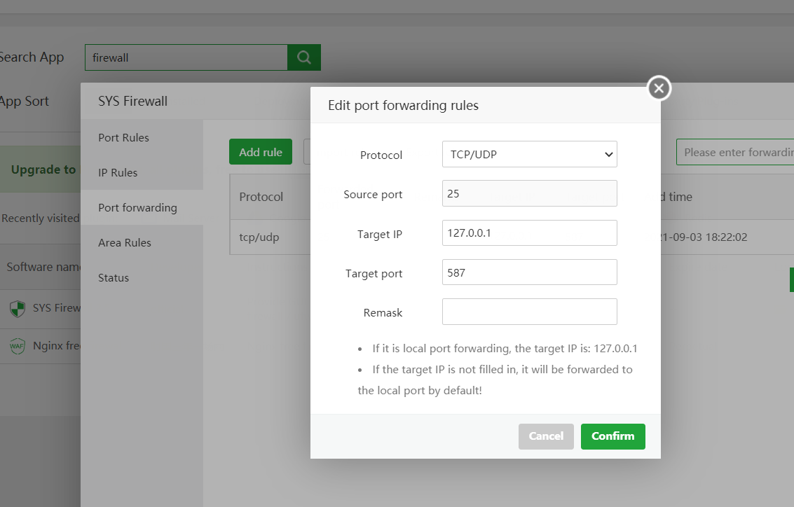

I change the postfix port to 587 because here in Brazil the 25 port is blocked (to block spammers)
nano /etc/postfix/master.cf
I edited:
##smtp inet n - n - - smtpd
587 inet n - n - - smtpd
So I could to send emails but not to receive.
The trick is Firewall > Port forwarding > redirect port 25 to 587

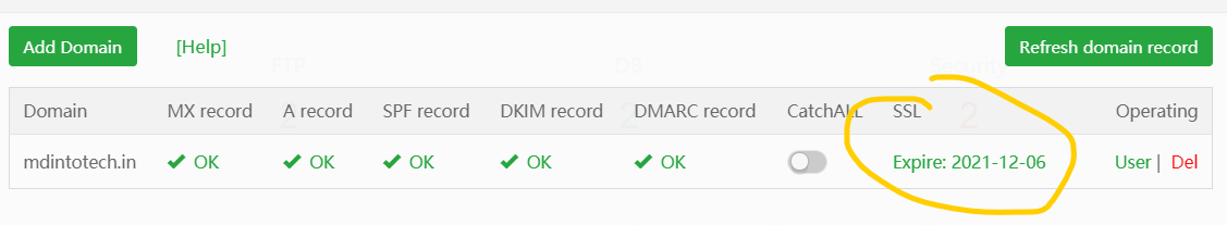

I was facing same issue but for Gmail I can send mail but can't receive from mail from Gmail. This happen may be because of SSL not configured on your mail server. After setting up SSL on domain and on mail server not mail coming in mail server from Gmail. May be that will help you or other out.
manthanesc Please how did yours come with automatic ssl for the email?
Joemires Hello, you can see his screenshot, the yellow place, there will be deployment of SSL related functions
aaP_richardreoc
The target ip is wrong.. Put your aapanel ip
Joemires
just click on yellow.
the auto generate certificate like:
*.site.com
site.com
Copy and paste it from email to the websites instead auto generate again.
