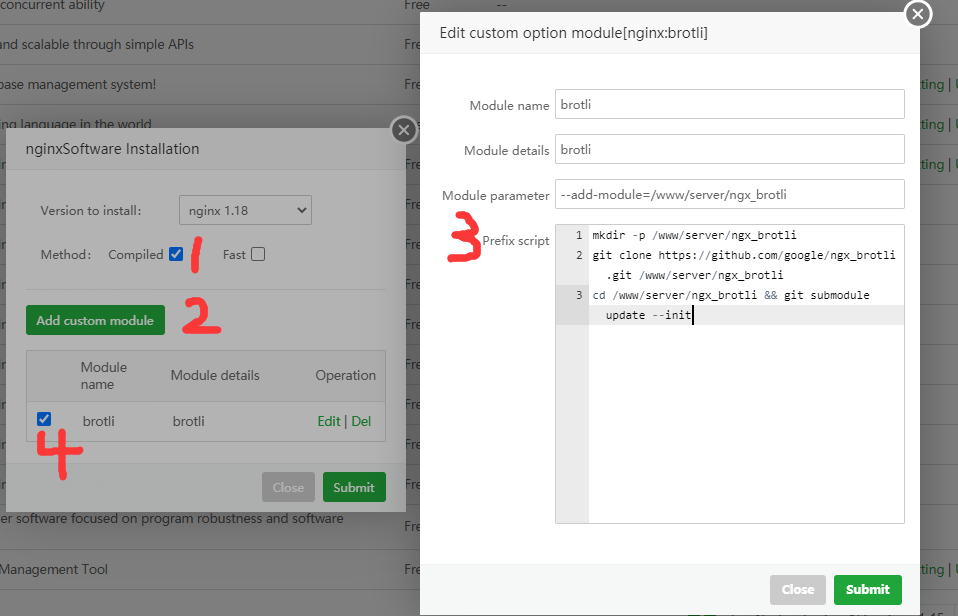

1. Choose to compile and install when installing nginx
  2. Fill in the parameters according to the screenshots and check the custom modules you need during installation.
--add-module=/www/server/ngx_brotli
mkdir -p /www/server/ngx_brotli
git clone https://github.com/google/ngx_brotli.git /www/server/ngx_brotli
cd /www/server/ngx_brotli && git submodule update --init

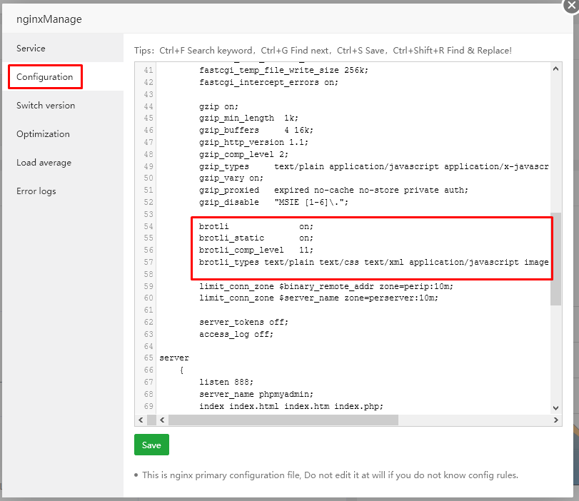

    and add brotli config to nginx configuration
    brotli              on;
    brotli_static       on;
    brotli_comp_level   11;
    brotli_types text/plain text/css text/xml application/javascript image/x-icon image/svg+xml;

    huaanhhuy
    Add this:
    brotli on;
    brotli_static on;

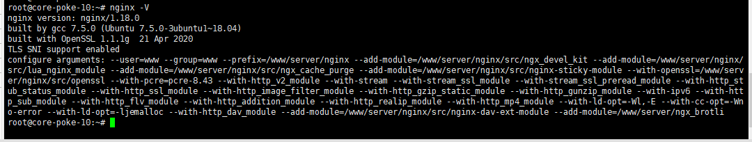

            Turbine
            I also encountered the same issue, however, when I checked, GIT was still not installed on my server. After installing it, it worked.
