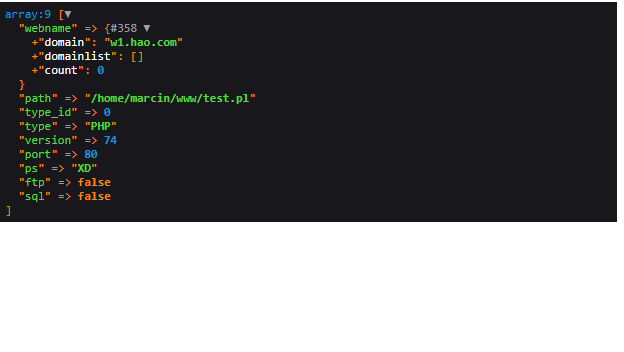

Hello, I have a problem with the API. I'm trying to add a page using your API.It gives such parameters, they are the same as in your panel.
"{"status":false,"msg":"Specific parameters are invalid!"}"

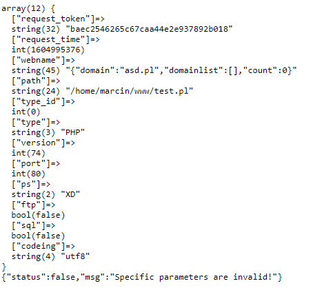

Your encoding parameters are not submitted
I added the "codeing" parameter and then the same.
@JAY Maybe you know how to fix it
marcinek7331
Please check if the interface you requested is correct
marcinek7331 add an extra param called "action" to the post request and put in value "AddSite", i just figured this out having the same issue using the php code ...
