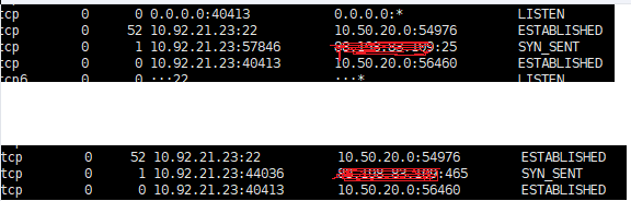

    I had a fresh install on an Ubuntu 22.04 about 20 days ago, and that server is OK, today the same setup is not working, it's a fresh Ubuntu 22.04 I can see SYN_SENT on local sever netstat but no packets on the mail server, I've tried port 465, 587 and 25, nothing seems to work.

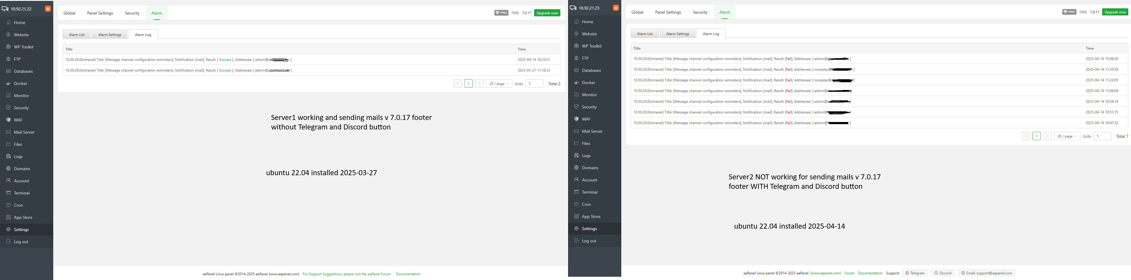

      Here are two pictures Server1 is OK Server2 does not send mails,
      I can't see anything in the mail server logs, here is netstat from Server2
      Same subnet, same gateway, same mail serve, same email settings, Server1 is working, Server2 is not working

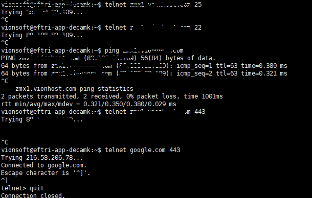

        Hi, I've tried to pinpoint the issue, I had 2 servers connecting 2 servers not connecting even with telnet.
        I've rebooted the server few times it didn't work before, now rebooting the servers I can telnet, updated to new version 7.0.18 and was able to setup the mail configuration
        the strange issue was that I was able to ping the mail host but not telnet 25, 22, even 443, like outgoing connection to that server were blocked, I can telnet google at 443, I checked the remote mail server firewall it was not blocking and finally rebooting the local server solved the issue. I've rebooted it few times before when I was testing it didn't help before.
