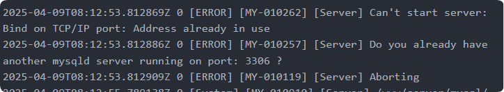

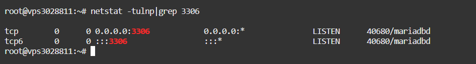

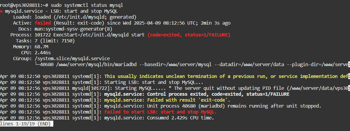

aaPanel_Kern Using different ports, it is recommended that you check what program is being used. netstat -tulnp|grep 3306 aaP_erwinborneo30

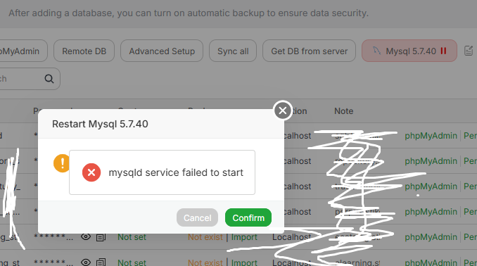

aaPanel_Kern Hello, I suggest you check the mysql log, what is the reason You can also use this command to check: curl -k https://www.aapanel.com/script/mysql_check.sh | bash her1saputra

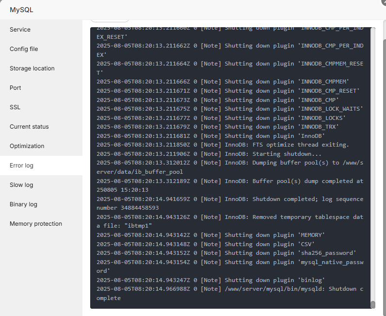

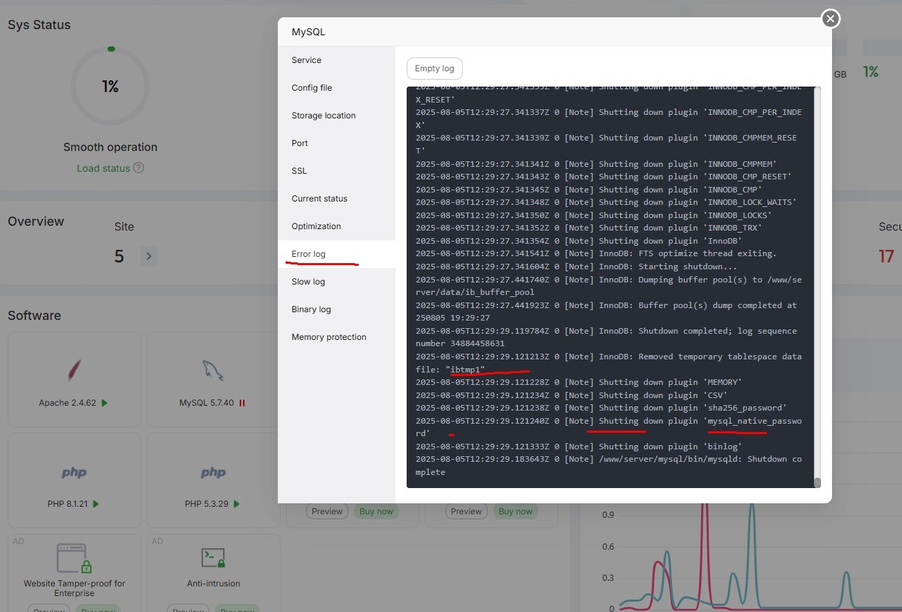

aaPanel_Kern It is recommended that you check if there is an error log in your screenshot, I have not seen it her1saputra
aaPanel_Kern Hello, You can use this command to check: curl -k https://www.aapanel.com/script/mysql_check.sh | bash her1saputra
