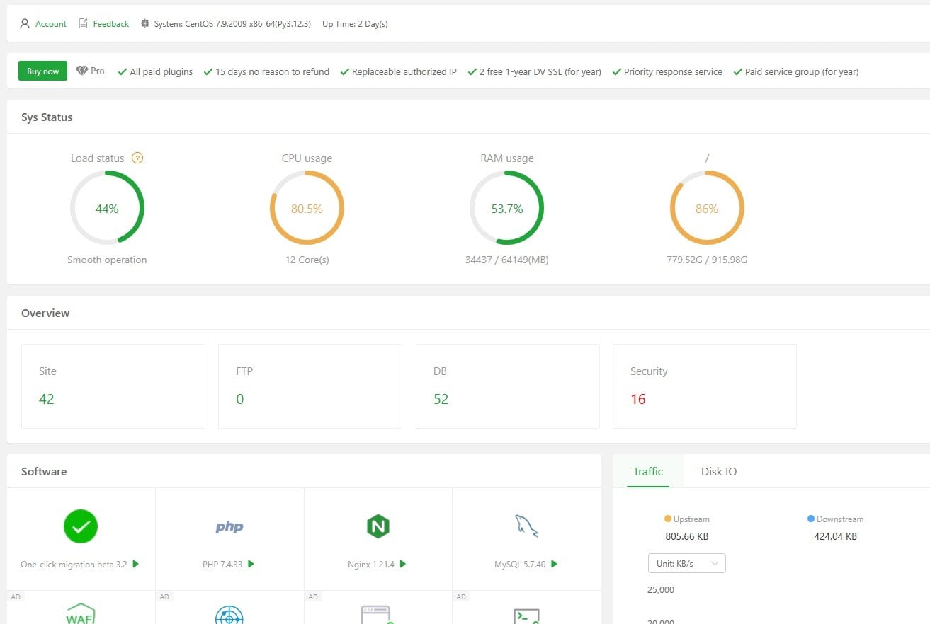

/dev/mapper/centos-root automatically increases the capacity, about 10s it will increase 0.01G, I turned off all logs but it did not improve, can you please tell me the reason?
/dev/mapper/centos-root auto increase size

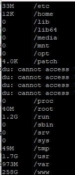

Hello, it is recommended that you use du -sh /*
to see which directories occupy? / You can change other directories to view detailed directories
It may also be that the program is not released during use

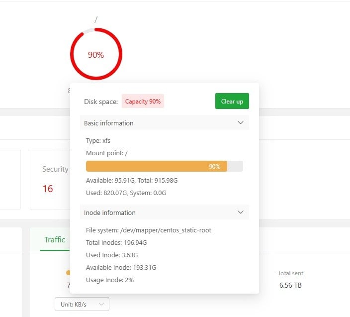

i deleted all the logs and everything was fine for a while but it happened again, all my data is only about 300GB but the system says it has used more than 800GB, i don't know where the remaining 500GB is
Hello, it may be that the program used the deleted file that was not released. It is recommended that you make a server snapshot backup and restart the server.
