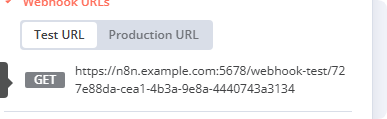

tieuca How to fix this error? I have tried configuring it as shown in the image to change the URL, but it still doesn't work. Thanks.
aaPanel_Kern https://docs.n8n.io/hosting/configuration/configuration-examples/webhook-url/ https://docs.n8n.io/hosting/configuration/environment-variables/endpoints/ Hello, It is recommended that you refer to the official document tieuca
tieuca I've tried but was unsuccessful. Could someone guide me on which file to edit and where when using Docker on aaPanel?
aaPanel_Kern https://docs.n8n.io/hosting/installation/server-setups/docker-compose/#5-create-docker-compose-file N8N_HOST: n8n.example.com N8N_PROTOCOL: https Configure this and Stop n8n_xxxxxx , and Start Check docker exec n8n_xxxxxx env tieuca
