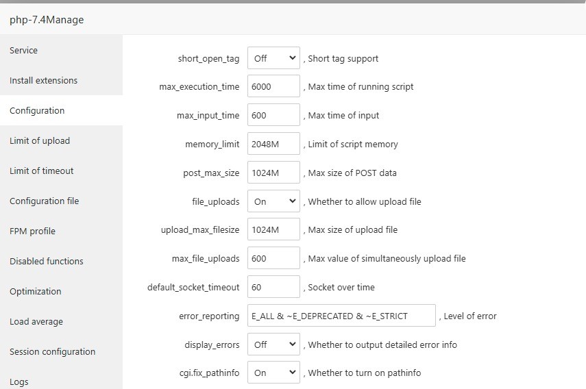

          for now the configuration that I do in php 7.4 is like this:
          and for the web service that I use is OpenLiteSpeed.
          Thanks
          Hello, it should be the incorrect default_socket related to PHP configuration.

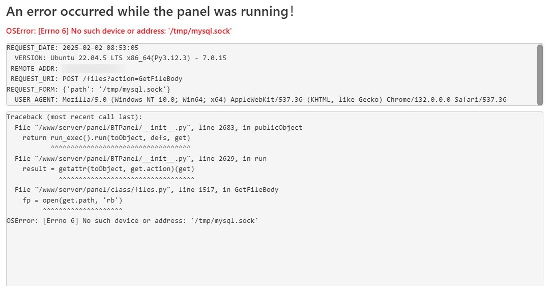

          Please check whether it is /tmp/mysql.sock
          Thank you for your response, for now I try to do your command related to checking /tmp/mysql.sock.
          but when checked, the result is like this:
            Hello, you should check in the configuration of PHP
