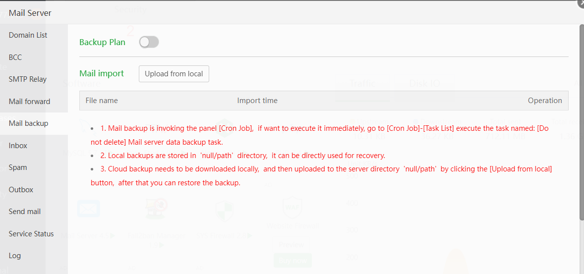

The mail server specifies that you can make a backup, which is stored in the directory 'null/path'. Where is this directory? How can I find it?
Hello, what version is your mail server?
The default is in the /www directory

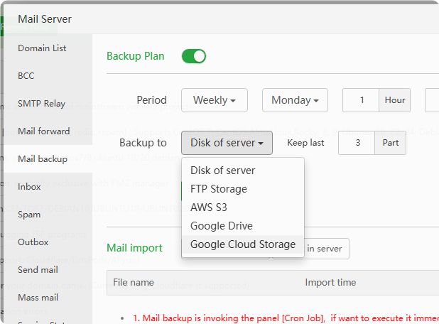

"Backup to" --> how to add additional NFS storage or other?
Hello, you can modify the corresponding task in Cron and choose to backup to FTP, aws s3, Google Drive

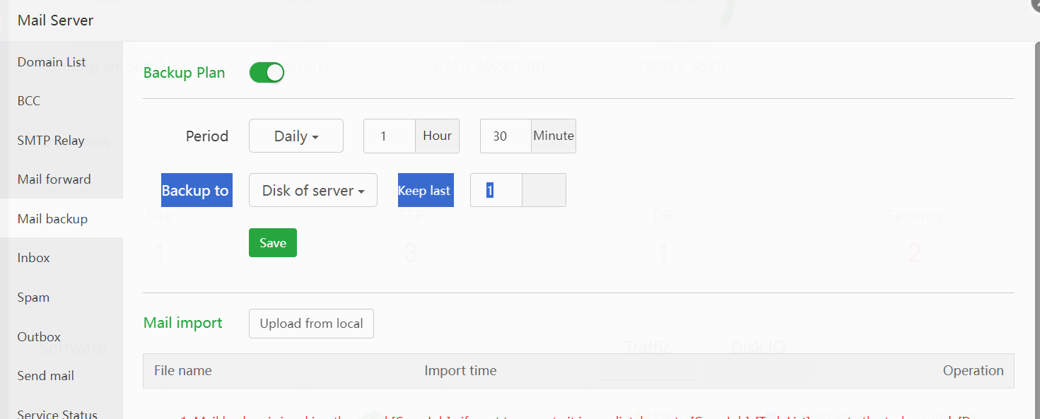

I'm talking about this section. How do I add a directory so that it can be selected from the list?
Hello, is this it? You can install the corresponding plug-in in the App Store and then configure it. to choose
aaP_randreevich
This is it. Plug-in - thanks, installed, list appeared.
