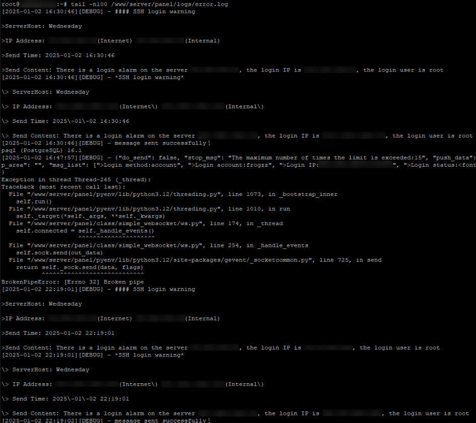

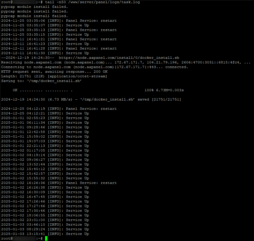

      Hello, is the server load normal? Are there any screenshots of the top command?
      You can also check the logs
      tail -n20 /www/server/panel/logs/error.log
      tail -n20 /www/server/panel/logs/task.log

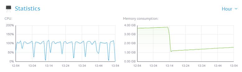

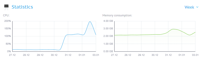

        This screen from my hosting panel statistics for the week:
        per hour:

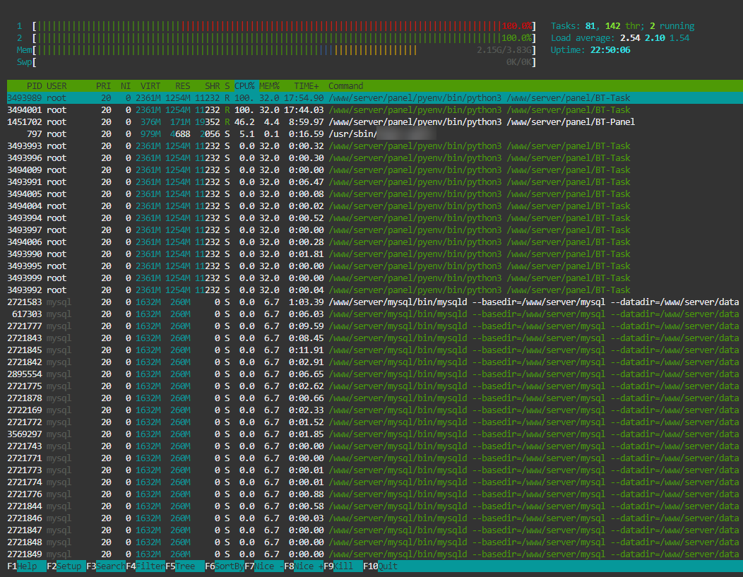

        I wanted to show the real-time load from "htop", but as luck would have it, I get into a time period when resource utilization has not yet reached its peak.

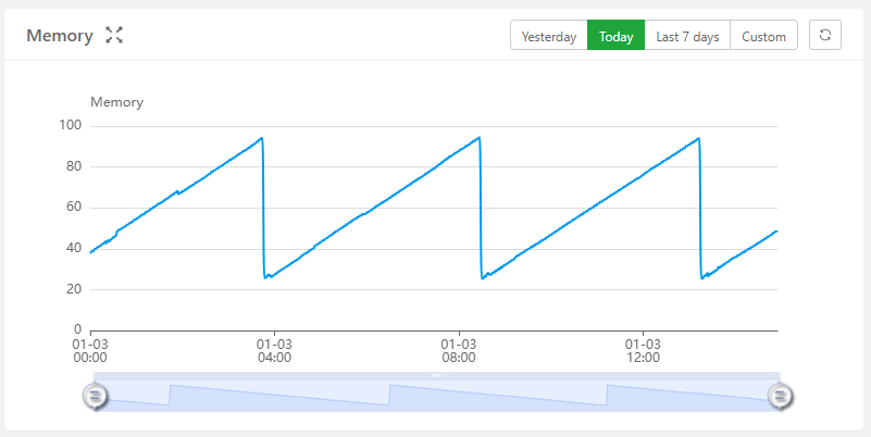

        The graph of the monitoring section shows that utilization is formed within 4-5 hours, every 4-5 hours.
        Monitoring:
        But monitoring does not see the bt-task in all graphs.

        Managed to catch increased load from bt-task
