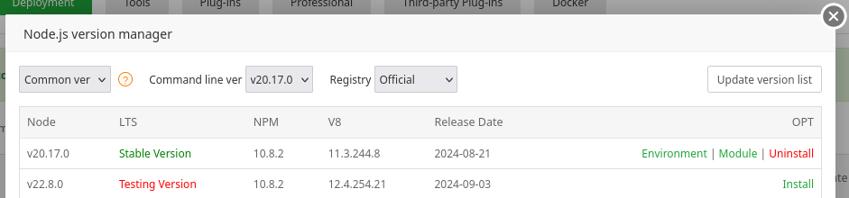

Hello, I'm facing issue with Node.js installation on AlmaLinux 9.4. After installing Node.js version manager, I went to install stable Node.js version from Official server and then set the command line version, but when I open the terminal, the designated node
or npm
not found on server. Any help are appreciated.
