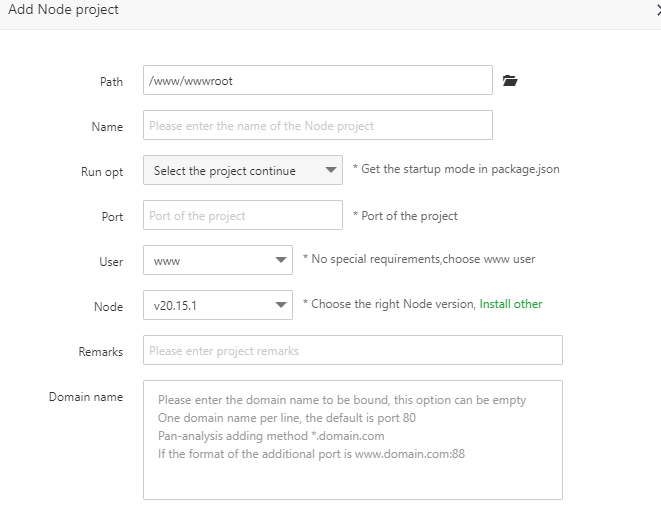

- Use first build command in the RUn options window to build your project
