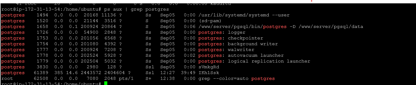

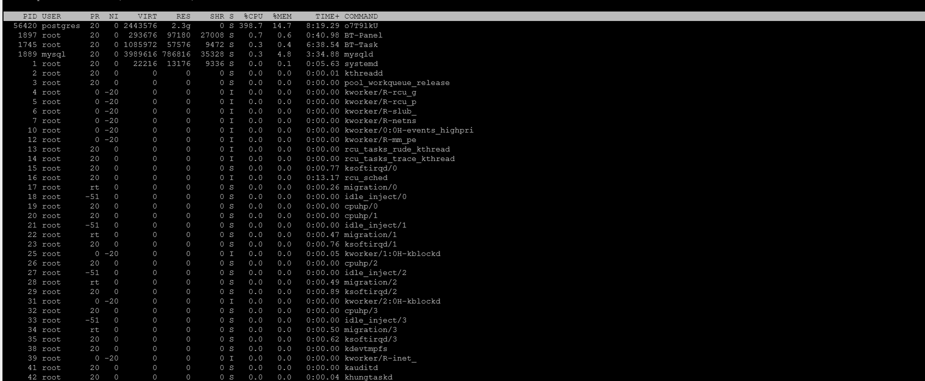

postagre process utilize 100% cpu even we dont have any database
postgre utilize 100% CPU
Hello, this may have been hacked. It is recommended that you check the process of this user.
aaPanel_Kern is there any where to find if some one running script ??
Find the running ID and running file according to the process.
see this
ls -l /proc/3830/exe
ls -l /proc/61389/exe

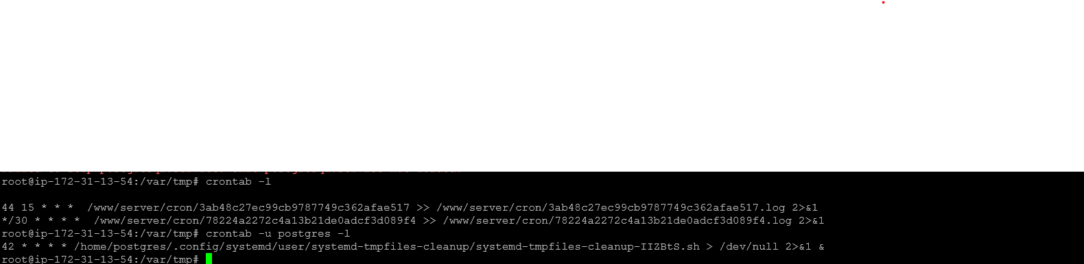

Could you please check what this is? What is the content of the following file?
Also check cron for any strange tasks
crontab -l
crontab -u postgres -l
pls check
- Edited
Aapanel will not add this task. It is recommended that you check whether it is added by your website program?
If not, it is recommended that you back up the data, make a server snapshot backup, clear the relevant exceptions and proceed with the task.
aaPanel_Kern thanks, i have found some script from some hacker , i have developed cronjob and script

the same problem
Hello, is your problem solved?
- Edited
technothumb
Hello, is postgres open to everyone to access: 0.0.0.? There is SQL injection in the program, which leads to the execution of sql code in pgsql.
