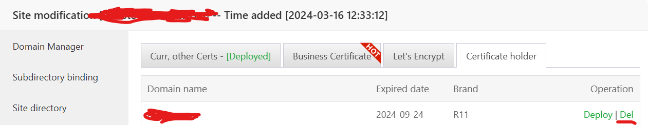

I have a website with multiple domain names associated with it. Yesterday, I deleted a domain name from the certificate holder tab within the SSL section, and the entire website entry was removed from the Website menu in aaPanel. This was something I didn’t expect. Despite this, the site is still functioning normally, and the website’s folder and database still exist.
How can I restore the website entry in the Websites menu dialog so that I can edit it again? Please advise.

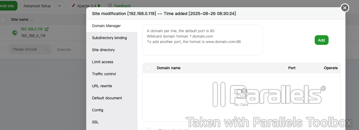

  • aaPanel_Kern /www/server/panel/data/default.db Then use the SQLiteStudio tool to check whether there is a relevant domain name in the sites table. If so, please delete the row of the relevant domain name, and finally upload the file to the same location Restart aapanel again. Be careful to back up the files first to avoid other errors

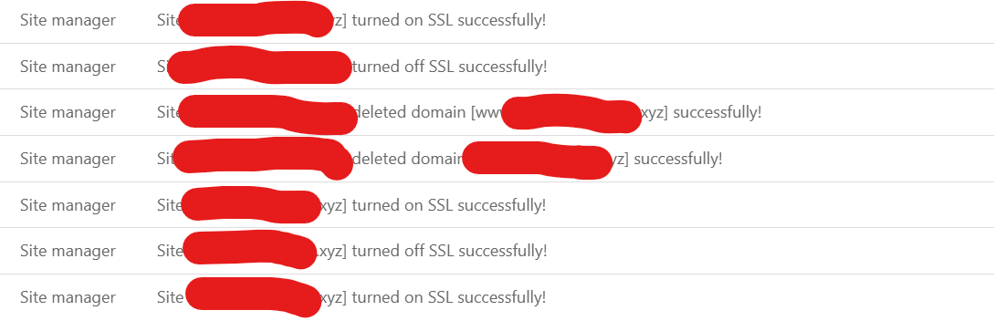

    Hello, did you delete the website instead of the certificate? You can check the panel operation log in the log interface.

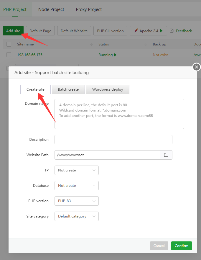

    You can try to add a website using this domain name. It is recommended to back up the server before proceeding.

    No I just deleted the domain name which was one of many that the website had.
    I tested deleting the certificate which only deletes the certificate and does not delete the website

      What is your website? Where do you plan to build? If it is a PHP Project interface, it can be created directly

        Hello, could you please tell us how you would create it? If created this way, there is no need to create a database. Because you did not delete the database
        This operation only adds the domain name and web configuration files. However, it is still recommended that you take a server snapshot backup

          I tried your suggestion but it says that the domain you try to add already exists.

              I create a website with domain name xxx.xyz, Then I added two more domains on it xxx.com, and xxx.eu. then after a while I wanted to remove the domain xxx.xyz that I initially created the site with. I deleted the ssl as I explained above and the website entry of the initiall create website was deleted.
